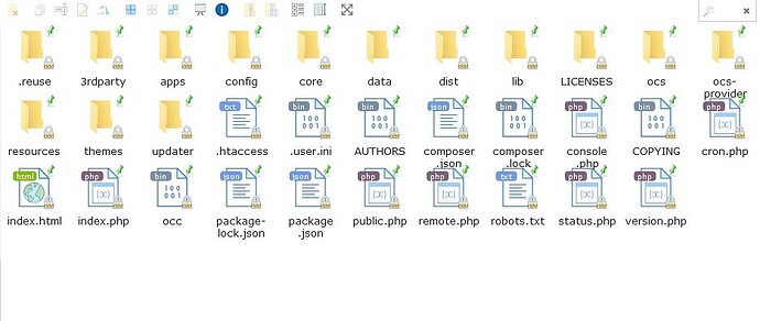

My files are intact but the NC folder contains fewer files than it should.
This is the current content of NC
Index. Public. Remote. and Static. they all contain the same code.
This is the contents of NC’s automatic backup from a week ago
I wonder if I can overwrite all the files from the backup (except my data) in the main folder?
Those smaller files are just the temporary entrypoint files put in place to keep clients from getting confused during the in-progress update.
Anyhow, can’t determine what happened for you originally (more on that in a moment), but you can do a manual upgrade to recover (which is less scary than it sounds).
