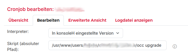

You could try to execute it as a cronjob – I do that on Hetzner instances with 384 MB memory limit:
/usr/www/users/{youraccount}/{ncdirectory}/occ upgrade
Thanks, will try both options.
