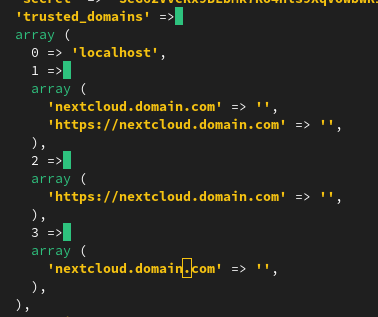

I can’t figure this out, I have looked at the forums and any solution that I find doesn’t work. I followed this guide: https://www.baeldung.com/linux/nextcloud-snap-installation. I installed it using snap, here is my /var/snap/nextcloud/current/nextcloud/config/config.php file
<?php $CONFIG = array ( 'apps_paths' => array ( 0 => array ( 'path' => '/snap/nextcloud/current/htdocs/apps', 'url' => '/apps', 'writable' => false, ), 1 => array ( 'path' => '/var/snap/nextcloud/current/nextcloud/extra-apps', 'url' => '/extra-apps', 'writable' => true, ), ), 'supportedDatabases' => array ( 0 => 'mysql', ), 'memcache.locking' => '\\OC\\Memcache\\Redis', 'memcache.local' => '\\OC\\Memcache\\Redis', 'redis' => array ( 'host' => '/tmp/sockets/redis.sock', 'port' => 0, ), 'log_type' => 'file', 'logfile' => '/var/snap/nextcloud/current/logs/nextcloud.log', 'logfilemode' => 416, 'maintenance_window_start' => 1, 'passwordsalt' => 'TLocVgDIgSLTY3NIvCEZSeYQ/NqXeZ', 'secret' => 'SeG6zVveKx9BLbMk7Ko4Hls9XqVoWbWR17jClrauM82/K8vF', 'trusted_domains' => array ( 0 => 'localhost', 1 => array ( 'nextcloud.domain.com' => '', 'https://nextcloud.domain.com' => '', ), 2 => array ( 'https://nextcloud.domain.com' => '', ), 3 => array ( 'nextcloud.domain.com' => '', ), ), 'datadirectory' => '/var/snap/nextcloud/common/nextcloud/data', 'dbtype' => 'mysql', 'version' => '30.0.4.1', 'overwrite.cli.url' => 'http://localhost', 'dbname' => 'nextcloud', 'dbhost' => 'localhost:/tmp/sockets/mysql.sock', 'dbport' => '', 'dbtableprefix' => 'oc_', 'mysql.utf8mb4' => true, 'dbuser' => 'nextcloud', 'dbpassword' => '4StZm09Zk9nzSmHHX-H7dL-SFRihbpX9nvRryDIztZvJoFEYNafDT3tI4igO_HmL', 'installed' => true, 'instanceid' => 'ocn9n1kascls', ); Whenever I try to access the instance, it gives me the accessed through untrusted domain. I have enabled https with lets encrypt so I do access it with https. I also tried on a previous vm to access it with just http on its ip address, then with its domain on http. I added the domains in a similar way earlier before. This time I used the command in the guide, previously I opened the file and added the domain.

Oh my I didn’t realize how terrible I put it in, I was so tired last night.
Ok, so that is what I did before. I just changed it back to that structure.
I am running ubuntu 22.04, the snap version of nextcloud. So I am changing the config file under /var/snap/nextcloud/current/nextcloud/config/config.php
I needed to add a comma after the array, otherwise I get an internal server error.
However, what I had was what happens use this command: sudo nextcloud.occ config:system:set trusted_domains 1 --value= example.com
which results in this:
Screenshot from 2024-12-20 09-53-31
Ok, I changed it to what you said and it is working. I really wish I had my old config to see what I did wrong. this is like the 3rd or 4th time I’ve set up nextcloud so I was pretty confident that I knew how to enter in the trusted domains for the config file. I guess I’ll close this. Thank you!!!

your trusted domain settings as per screenshot may work now, but they are not correct. you should read PHP configuration options
it should look like this:
  array (
    0 => 'cloud.yourdomain.xyz',
    1 => 'cloud.yourotherdomain.yzx',
    2 => 'localhost',
    3 => 'nextcloud.local',
remove the protocol from the domain names
