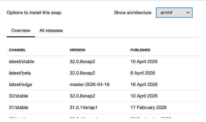

Hi @RolandKwee !
You most likely are on an armhf OS, and I’m afraid that arch is not supported anymore by the nextcloud-snap since the upgrade to MySQL 8.4.
That would explain this:
    • 32.0.8snap2
No this is a fresh install.
The solution is to use an arm64 OS instead.
