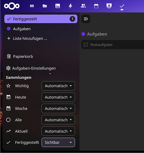

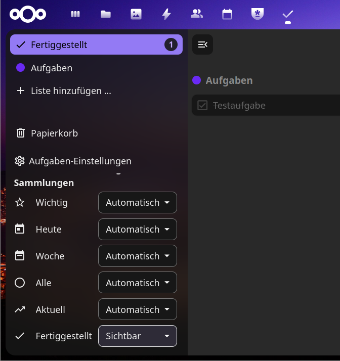

With Thunderbird (140.9.0 esr) it works as it shall work. If i ad a Task to NC-Tasks using Thunderbird and after i completed the task mark it as completed the task will be shown also in NC-Tasks as completed or not shown at all anymore (depending on seetings in NC-Tasks on Web-Interface)
So it’s maybe an issue with Betterbird but not with Thunderbird.
