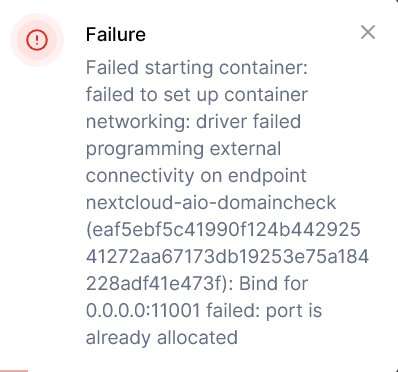

    I installed a Portainer agent on the Nextcloud server. I can see that there are 14 containers. All are running minus the [nextcloud-aio-domaincheck]…
When I try to start the stopped container, I get this error…
I have the nginx reverse proxy set up as per the AOI instructions. The Apache2 port is set to 11001. Not sure what is missing or inconfigured.
