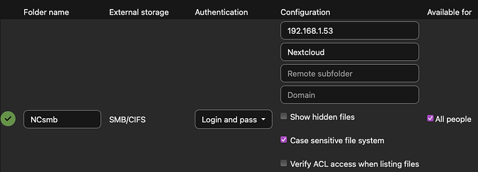

Finally got it to work. Here is the syntax I used to connect to my smb share:
sudo -u www-data php occ files_external:create NCsmb smb password::password -c host=192.168.1.53 -c share=Nextcloud -c user=xxxx -c password=xxxx
I removed the root=/Nextcloud and changed share=Nextcloud and renamed the folder to NCsmb. Now my external drive looks like this:
The green checkmark confirms that it’s connected.
Thanks for everyone’s suggestions
