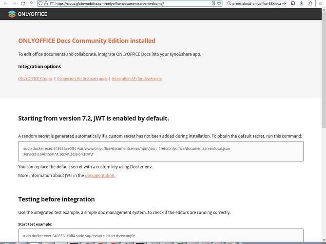

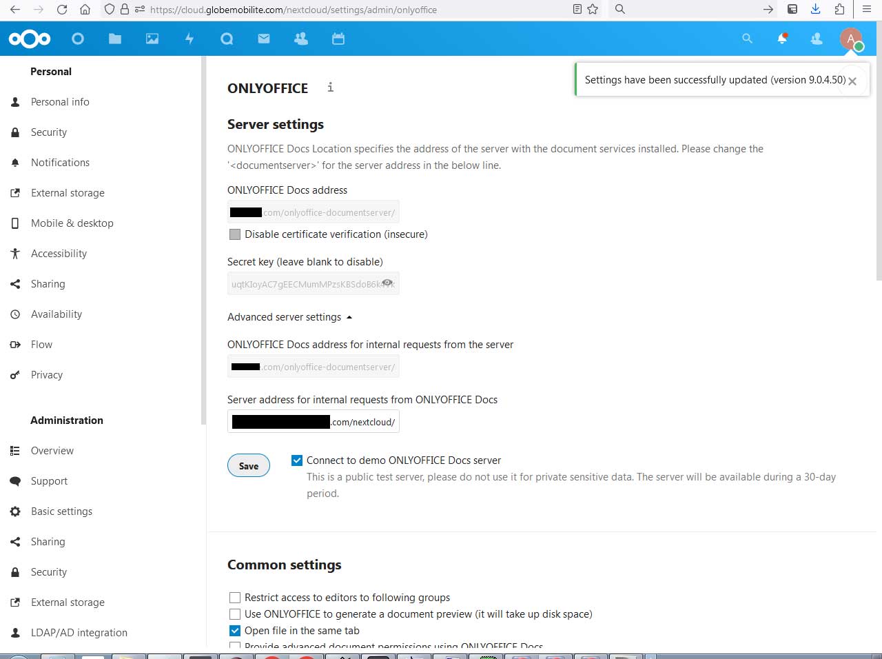

However, I have no idea how to get it to work with the included pre-installed OO. It does come already enabled from nc Apps, but still doesn’t work even if a disable and reenable it. Clicking on a .docx just let’s you download it.

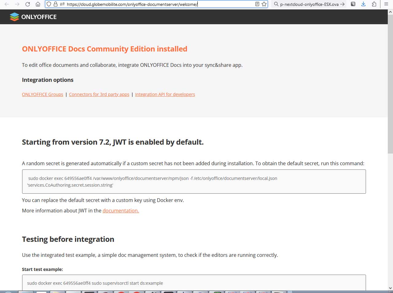

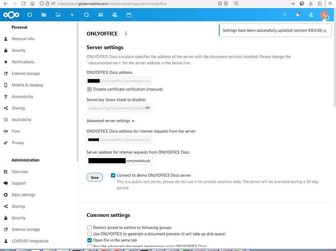

Nc does work with the OO demo server, but not when I disable the demo, regardless of what syntax I populate the server settings with, including grabbing the secret out from the OO welcome.

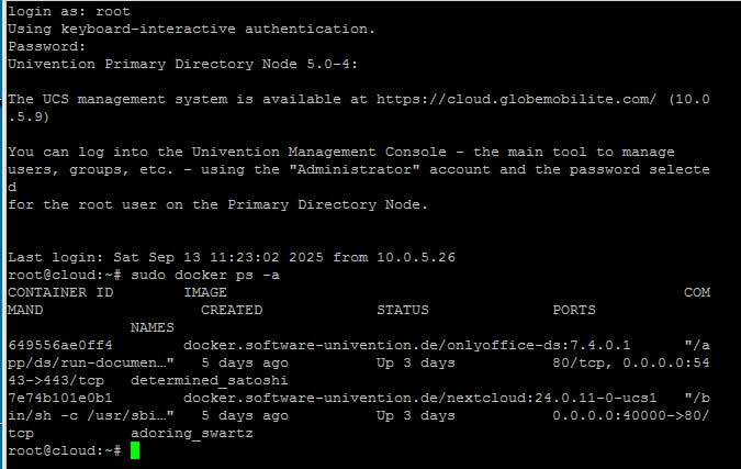

Did you install OnlyOffice from Univention App-Center?
Is the OnlyOffice docker container running? - Login to console and type “docker ps” - two docker containers should run: Nextcloud and OnlyOffice.
That was one of the first things I did to verify that I have deployed the correct image from UCS, and the oo welcome page shows that.

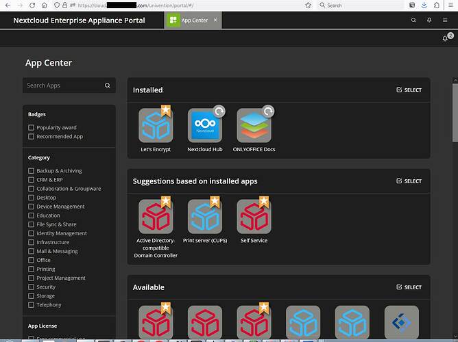

The App-Center shows, that Nextcloud and OnlyOffice need to be upgraded.
Because the is a version dependency between the Nextcloud OnlyOffice app and the Univention OnlyOffice (Docker-App), you should take care, to keep the latest release of both Apps and if you update the Nextcloud OnlyOffice App, you also need to upgrade the Univention OnlyOffice (Docker-)App, as far it an update is available.
(same with Collabora and Collabora CODE on UCS)
In my experience, vm’s generally work out of the box as the image was prepared.

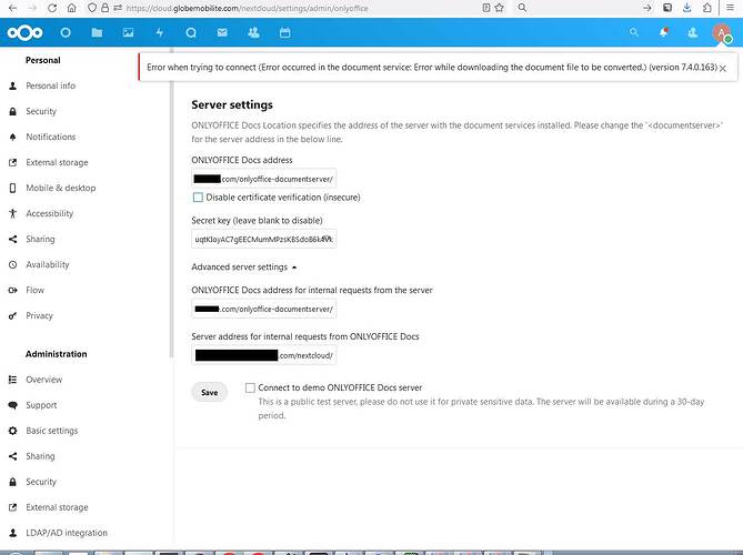

I have already mentioned that upgrading either or both of them still does not get oo to work.

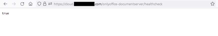

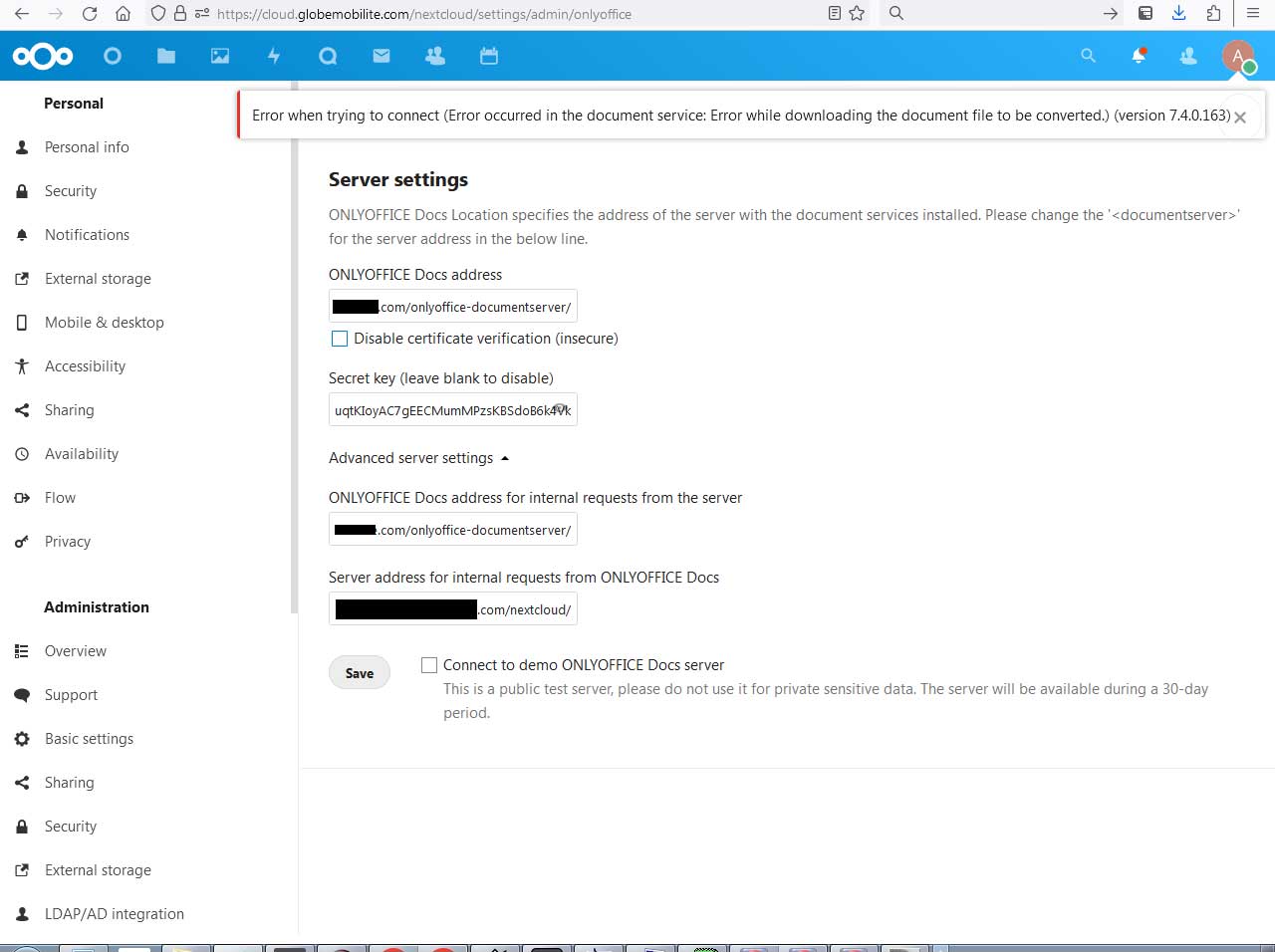

If I google for the error message in the 3rd schreenshot, I get a hit to this thread in the Univention forum:
Please note: The mentioned thread concerne to UCS 4.4, but your version seens to be 5.2 or higher.
So it might be better to ask in the univention forum for help.
I pass the healthcheck too, so I have no idea what else can be wrong.
I am sure it’s a config or json I have to edit.

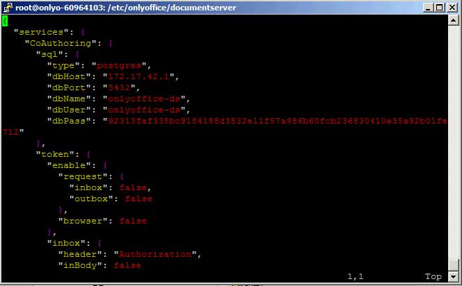

I poked into the docker container of oo and I saw a private ip in the dbHost, which I never typed in. Should I change this to my internal local ip? or fdqn external ip?
The docker IP should be known by UCS to forward the request to open the document. My Collabora instance had an 172.x.x.x IP on my UCS and it worked. But I turned off my UCS last week and replaced it by the Hansson-IT Nextcloud instance.

When I changed that 172.17.42.1 to localhost, the healthcheck no longer worked by responding with a 502 bad gateway. I have a feeling this is some internal ip defined by oo during it’s setup, generated or otherwise.
I have seen that dbHost is localhost from other local.json shared by other users.
You should not change the IP address.
