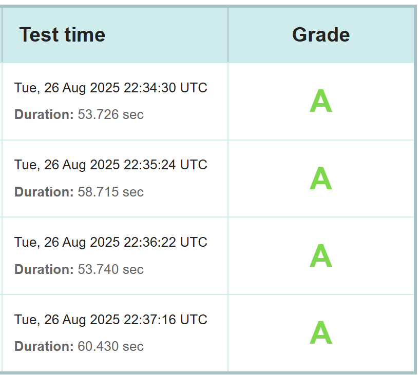

Note that I am running behind Cloudflare Tunnel, and the ratings for my server are all A, I am using TLS 1.3
I don’t understand why the behaviour is different (broke) on Linux but all good on other platforms.
