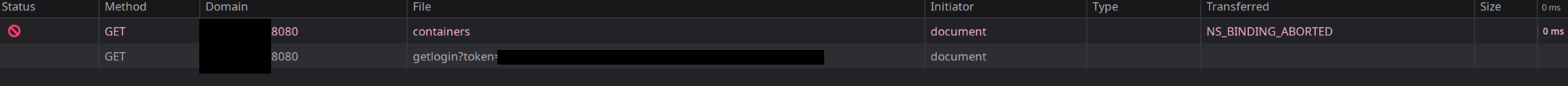

some extra details over this log file
to get this log file I did the following
  1. start the docker compose
  2. go to the web interface
  3. enter the passphrase
  4. get stuck on the loading wheel
here just pressed the “Open Nextcloud AIO Interface” button in Nextcloud
and waited for about 1 to 2 minutes before making this screenshot.
the console doesn’t show anything of note

Note
If I wait long enough I’ll be able to start nextcloud
however, having to wait 15 minutes or longer between every single button I press in the mastercontainer web UI is tedious and gets annoying if you’re trying to make a backup.
If I were to suffer through the loading times and be able to press the start containers button, Nextcloud will start correctly and everything within the Nextcloud web interface will work with the speed that is expected.
The only thing that is slow is the Mastercontainer
Hi, this sounds like the connection to external services might not work as expected.
Can you check the connection from inside the container to ghcr.io e.g. by using curl?
Also you might want to adjust the MTU of the docker network for testing purposes: https://github.com/nextcloud/all-in-one?tab=readme-ov-file#how-to-adjust-the-mtu-size-of-the-docker-network
Connection to ghcr.io is working correctly
adjusting the MTU of the nextcloud-aio docker network fixed the issue and the AIO interface now loads in about 10 seconds
Thanks so much!
