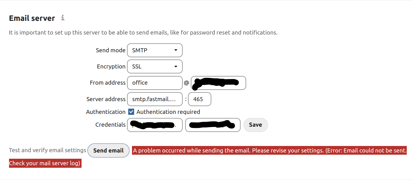

So I have followed my providers directions to a T but I keep getting this. I have also tried using Mailgun with out any luck. I check the mail error logs and there is not even an attempt to send an email in my logs. Is there some setting that I missing that needs to be turned on?
The SMTP server must accept the email sender’s From-address, specially the the mail domain name @mydomain.something
If the SMTP server has a different domain (f.e. @otherdomain.something) it does not accept the mails from Nextcloud.
Are encryption and port given by your mail provider?
Is SSL enabled in Nextcloud config.php?

Is this with configured with an app password ?
Yes it is configured with an App password
Yes I followed their directions to set it up.
Every other time I have done this SSL was supported.

I tested the connection on a different linux computer and I had no issues connecting with Telnet Ncat or Openssl. This leads me to believe something on my server is blocking the connection I just need to figure out what. Any ideas where to start?
Here is the info from my mail.log file if it helps. I don’t understand why it’s trying to connect to email.privateemail.com
