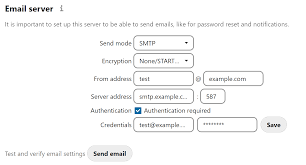

In the “Basic settings” of Nextcloud, I configured the SMTP user as:
user@domen.com
However, when I try to test the SMTP configuration from the Nextcloud interface (by clicking “Send test email”), it returns a 400 error.
So unfortunately, I cannot verify the connection through the web interface.

Thanks, that might help, You might to fix this first please, using the [manual] .
(Email — Nextcloud latest Administration Manual latest documentation)
The smtp howto is in link I’ve sendet already.
If the basic settings works, please let me know how the mailapp is working.

:page_facing_up: Mail configuration (example):
pgsql
КопироватьРедактировать
Mail server: mail.domain.com
Port: 587
Encryption: STARTTLS
Authentication method: LOGIN
From address: user@domain.com
Login credentials: Same as user login (SMTP auth works)
