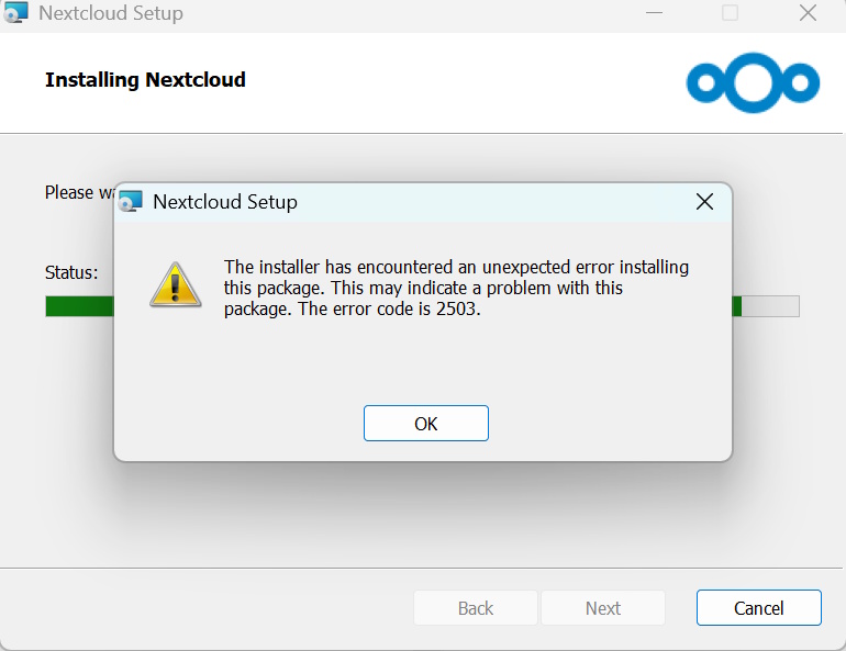

The Installer has encountered an unexpected error installing this package...The error code is 2503

    • trying to update Windows App from 3.16.4 to 3.16.5
    • .msi
    • `no’
  • Windows Version
    ‘Windows 11 Pro 24H2’
When notified about an update from the Windows 11 Desktop App I tried to install the update. The installer gets about 2/3 of the way done on the progress bar. I receive an error from Windows 11 "The installer has encountered an unexpected error installing this package. This may indicate a problem with this package. The error code is 2502 & 2503
  1. Install updates package - fail
  2. download and install package - fail
  3. Have not yet tried to uninstall nextcloud desktop app yet

Yes I do host it at home. I have tried the steps to clean up Windows 11 and no luck so far. Still have the same errors. My NextCloud server status show everything is ok.
I would have to agree that this is a Windows issue since I cannot get past the install of the .msi file.
Do you think uninstall the NextCloud App would help? I’m just afraid then I might be stuck if I cannot get the newer version to install

I do have a laptop I could try it on. Since it has been a while, I would just like to add that no other program I have installed has this error. Only the Nextcloud 3.16.6 app is giving this error

I have Windows 11 on the laptop also. I am running Nextcloud App v3.16.4 and everything seem to work fine. I just cannot update to the latest version of the Windows Nextcloud app

I didn’t have any problem with my laptop. I reinstalled windows on my desktop and the error went away for several months.
Now the latest update have the 2503 error again.
This is Windows 11. Is anyone else getting this error when trying to install the desktop app?
I finally was able to figure it out with the help of co-pilot lol. If anyone else is having this issue try this:
  1. Open an elevated Command Prompt
    • Press Win + S, type cmd.
    • Right‑click Command Prompt → Run as administrator.
  2. Use msiexec to run the installer
    • Navigate to the folder where your Nextcloud installer is located:
      cmd
      cd "C:\path\to\installer"
    • Run:
      cmd
      msiexec /i Nextcloud-x.y.z.msi
      (replace Nextcloud-x.y.z.msi with the actual filename)
    • The /i flag tells Windows Installer to install the package, and because you launched cmd as admin, the MSI runs with elevated rights.
:wrench: If Error 2503 Still Appears
  • Check Temp folder permissions:
    • Go to %temp% → Properties → Security → make sure your user has Full Control.
  • Restart Explorer.exe before running the installer.
  • Re-register Windows Installer:
    cmd
    msiexec /unregister
    msiexec /regserver
  • Verify Windows Installer service is running (services.msc → Windows Installer → Startup type = Manual).
Nextcloud‑specific tip
Users have reported that restarting Explorer.exe and then running the MSI via msiexec solves 2503 errors when updating Nextcloud Desktop on Windows 11.
Good Luck!
