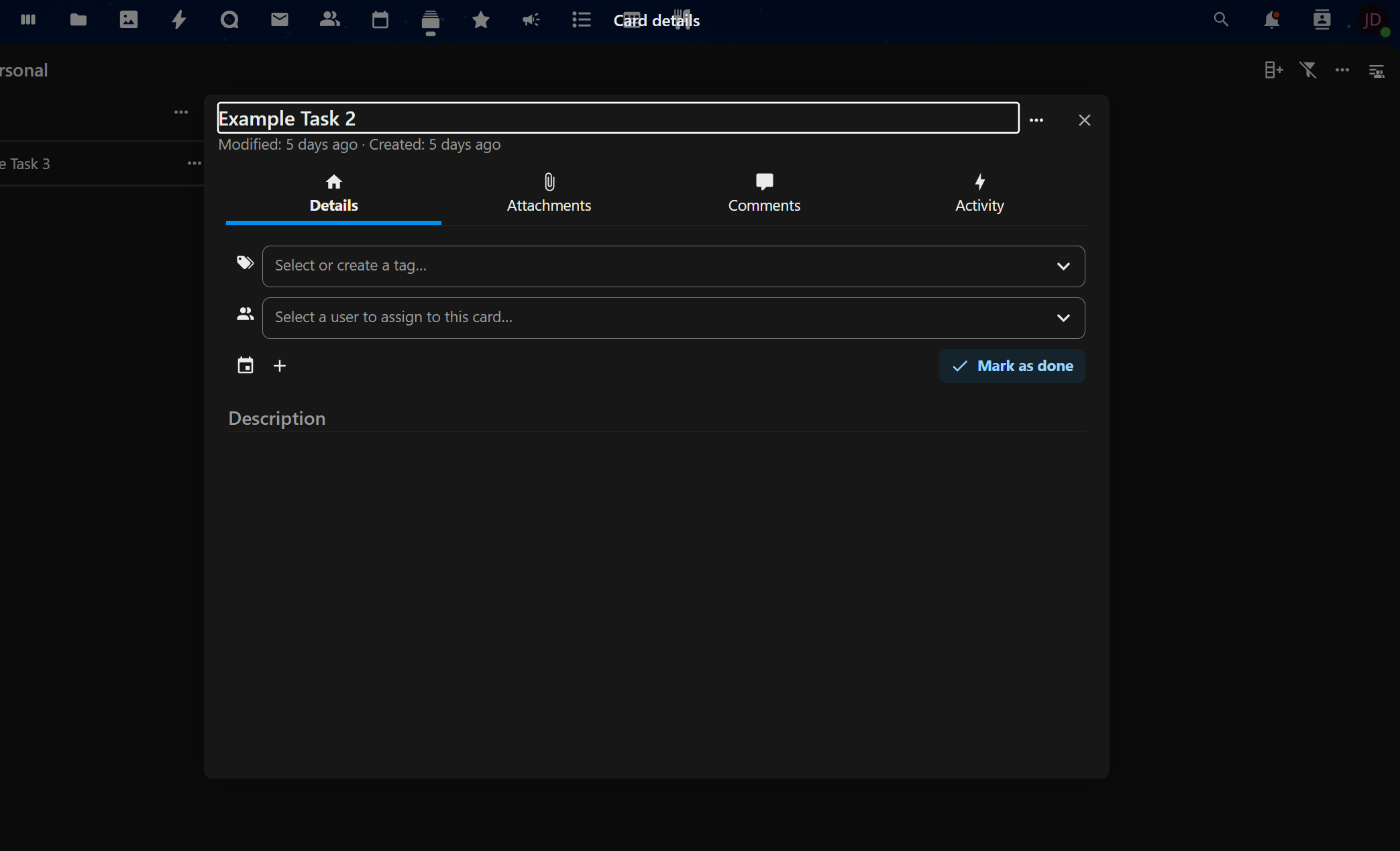

The description of a card in deck is not showing up as I expect it to
    • Nextcloud Hub 9 (30.0.6)
    • Ubuntu 22.04
    • Apache/2.4.52 (Ubuntu)
    • I don't know this
    • 8.3.16
    • no
    • `from the first time I used deck’
    • through plesk obsidian add-in
    • mod_security on plesk obsidian

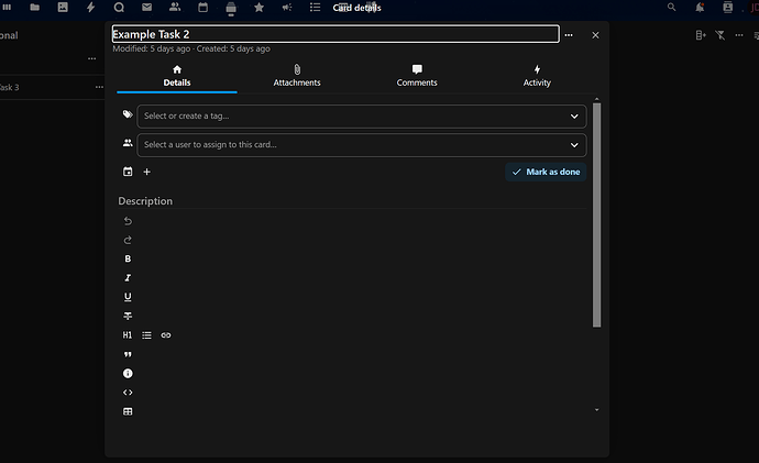

The description does not show the first time I open a card. After opening it 3 times, then the description shows with the formatting buttons vertical. like this:
The android app shows up like I would expect.

opening in firefox with the console window open I see that I am getting a 404 on the file: /nextcloud/apps/text/css/text-editors.css
My understanding is that the mime type errors is just because it was expecting to get a css file and instead it got the http 404 error.
So how do I go about determining why the text-editors.css and text-viewer.css files are not found?
