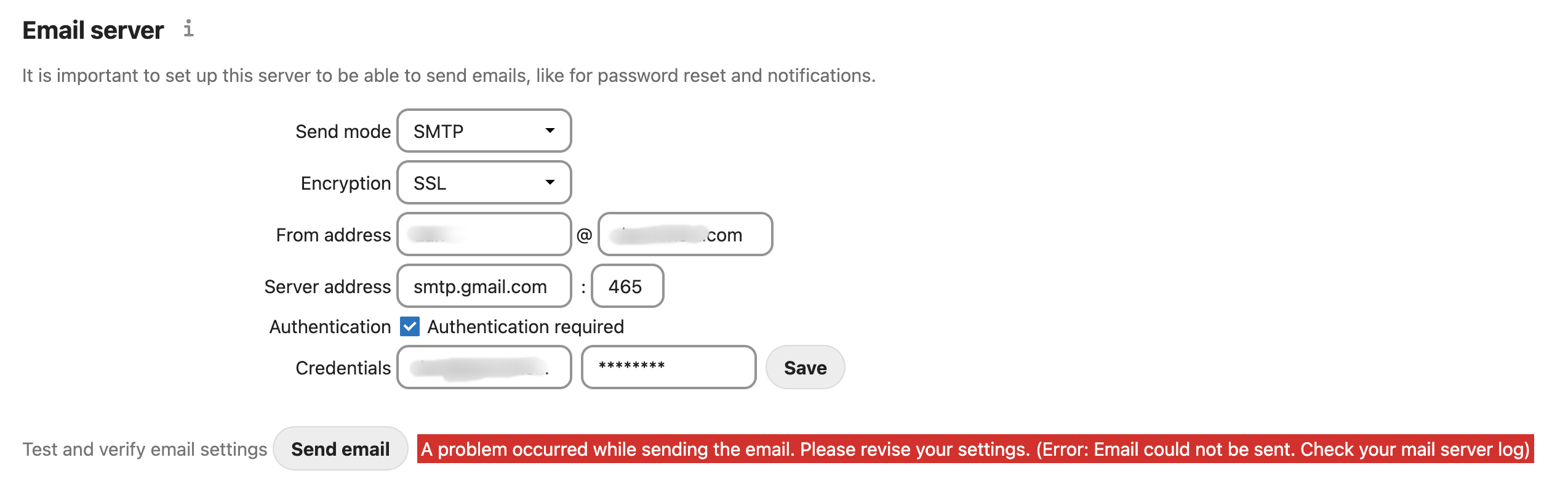

Have a synology/portainer/docker/Nextcloud installation 6 (27.1.3)
I have a problem to setup Email server in Basic settings.
Always running into error message:
A problem occurred while sending the email. Please revise your settings. (Error: Email could not be sent. Check your mail server log)
Tried with gmail and yahoo address. Both accounts 2-factor authorized.
Meaning created passwords and use it in the credential part.

Did you enter a valid Email Address for you Admin user under ā€œPersonal Settingsā€ → ā€œEmailā€?
I checked Personal Settings. In there I used the yahoo email address.
In the Basic Settings Email Server settings I used the gmail address.
This happened because I tested with 2 mail addresses. After changing to gmail and recreation of a new app password everything works now. Thanks for your help.
