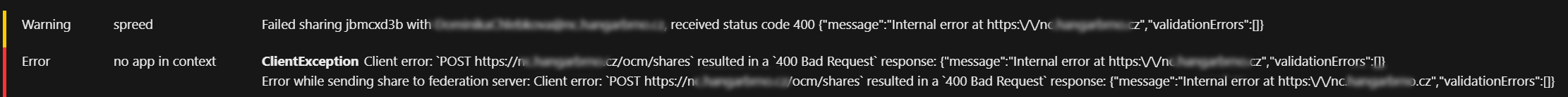

I have 2 freshly installed instances of nextcloud with the same configuration on 2 different sites (2 different domains) that I joined to federation. Both servers are added as trusted for federation and federation of files and folders seems to work, but creating federated conversation ends up with unspecified error. The log on each side says something slightly different.
One side gets:
And the other one:
The same happens through mobile app.
