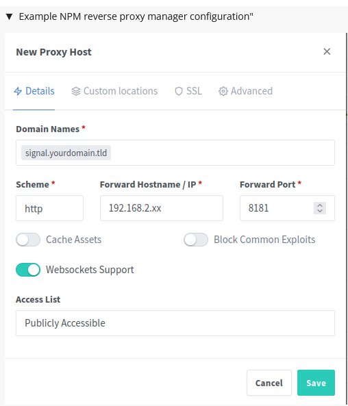

hey @cappleapple
I’m not using AIO nor Caddy, but that error seems familiar and has to do with “caching”… in NPM if “Cache Assets” is disabled the error disappears;
maybe there is a similar function in your reverse proxy that you could disable?
