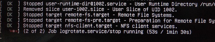

when executing in terminal “sudo shutdown now” it tages about 15 minutes until the system is down.
Please see the 2 attached screenshots that show the different steps when the shutdown process gets stuck for a longer time.
So the two jobs
rsyslog.service
and
logrotate.service
are taking very long (about 15 min) and are causing this issue.
I do not think that this long time for the shutdown is normal.
I would appreciate if someone could tell me whats the problem and how to solve it.

Thats right, but in my case there are two specific jobs during shutdown process that are taking very long and are causing this issue.
Thats:
Job rsyslog.service
and
Job logrotate.service
Thats why I attached the two screenshots.
So the questions still remains:
Why are these two jobs taking so long and by long I mean up to 15 min.
Does rsyslog (and subsequently logrotate) store any logs on a destination that is no longer available?
