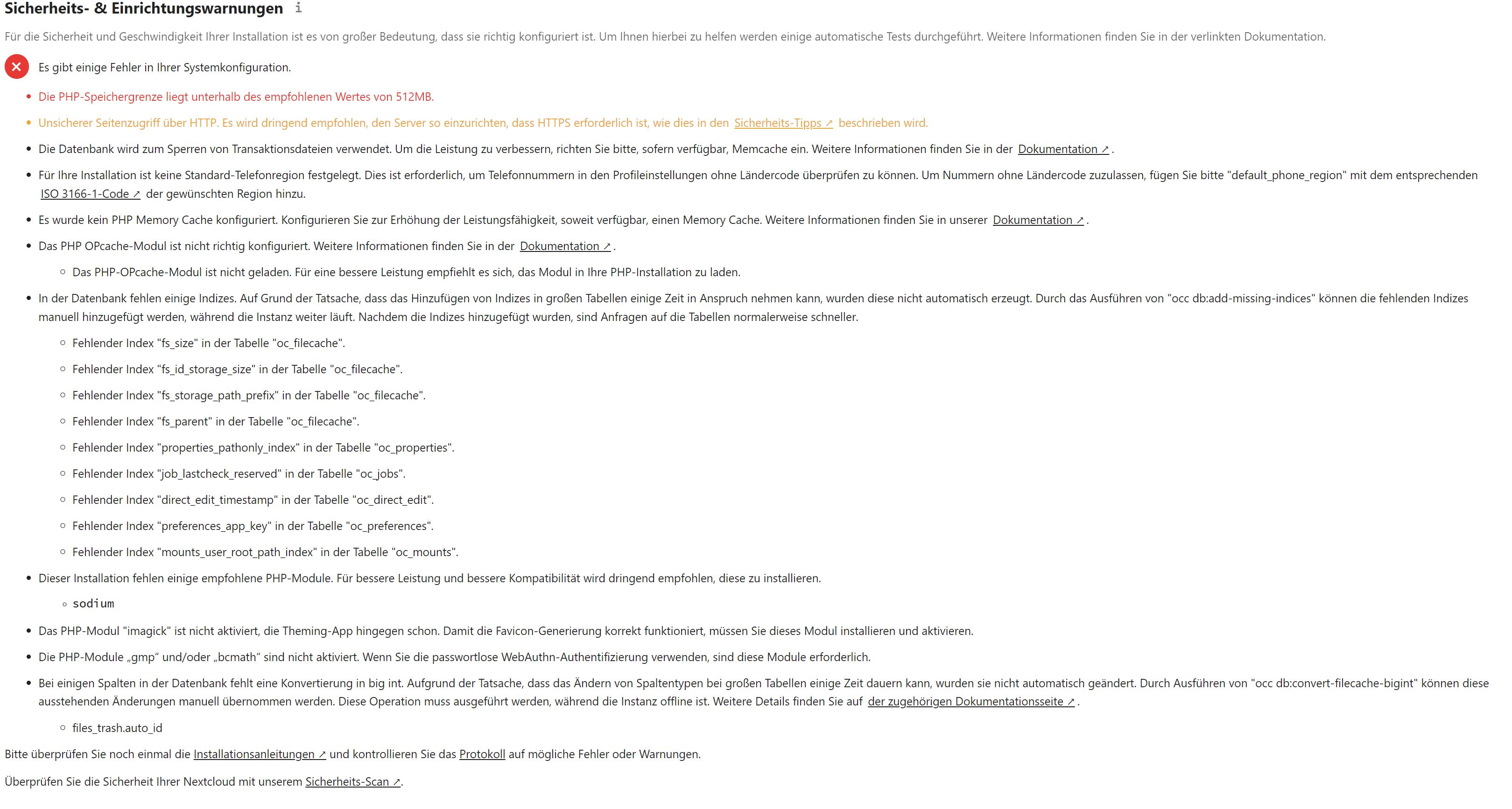

My nextcloud does not run properly.
Checking my installation there are many failures, list below.

Lets begin with the first, most important red message:
“Die PHP-Speichergrenze liegt unterhalb des empfohlenen Wertes von 512MB.”
That must be set in the php.ini of the php-sapi that talks to your webserver.
It is the value memory_limit that normaly comes with a value of 128MB. Alter it to at least 512

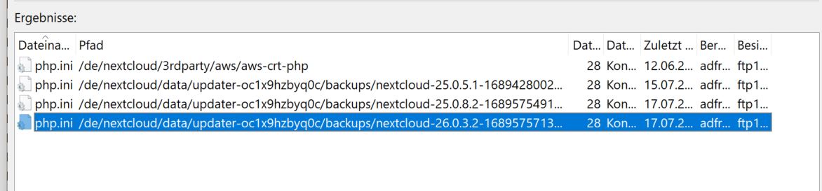

Did you find out the location of the php.ini to alter memory_limit?

Not until now.
Checked the nextcloud folder without results
Actually I check the complete websace and have to wait for any response.

Results:
In each the same comment:
extension=modules/awscrt.so
