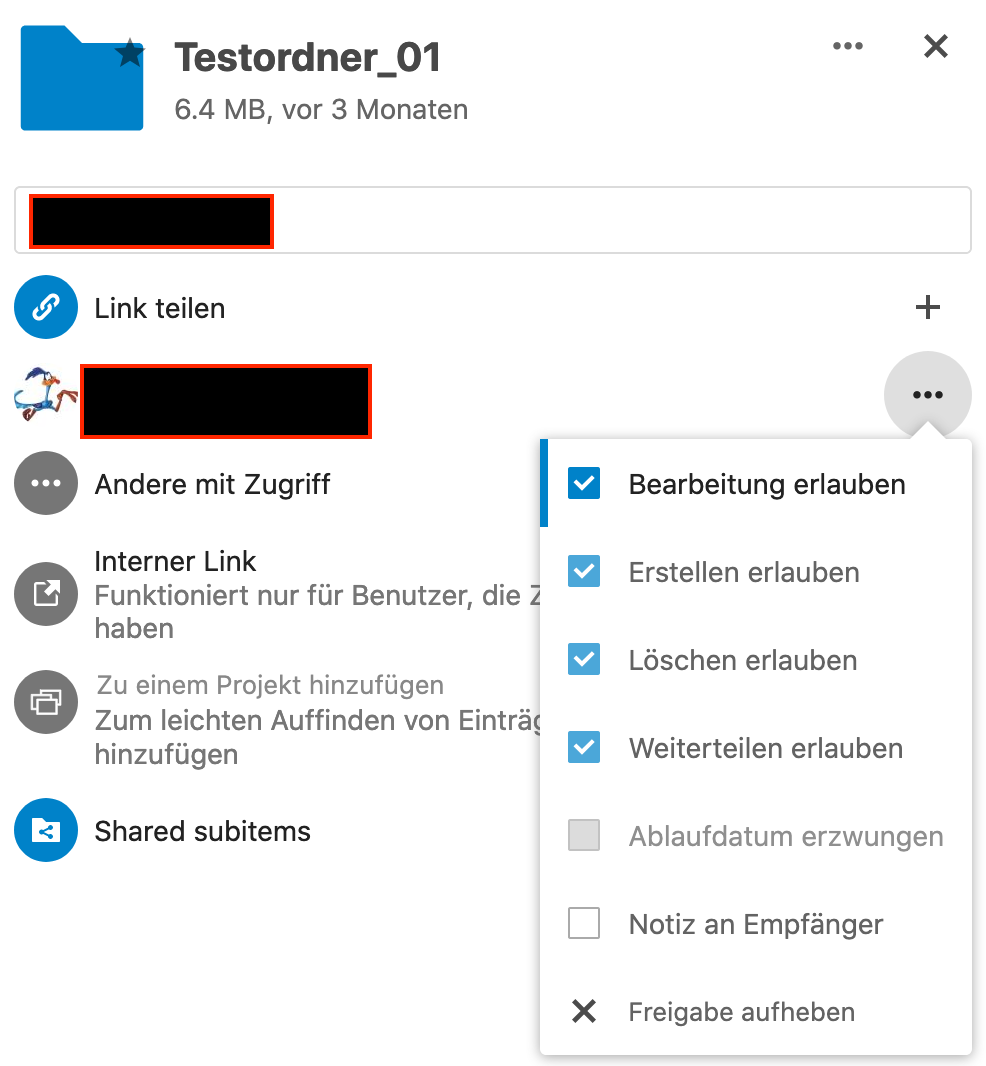

yes i am sure, that we have set the permissions correctly on the Server (see screenshot, but in german :wink:
Here are the share from a user to another (without set any permissions):
Thanks for your help!
Tom
Here the by the user:
The user can “umbenennen” (rename), “Datei löschen” (File delete)
My settings. I think you must set “Standardberechtigungen fĂŒr das Teilen”:
