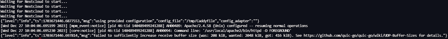

In fact, I didn’t get any error in my logs :
Apache logs (sudo docker logs nextcloud-aio-apache):
Mastercontainer logs :

Can you post the output of sudo docker logs nextcloud-aio-apache here?
I didn’t try to fix anything for the moment, here are the logs :
user@machine:~$ **sudo docker logs nextcloud-aio-apache** [Tue Dec 26 09:11:37.531615 2023] [mpm_event:notice] [pid 48:tid 139814917450568] AH00489: Apache/2.4.58 (Unix) configured -- resuming normal operations [Tue Dec 26 09:11:37.531678 2023] [core:notice] [pid 48:tid 139814917450568] AH00094: Command line: '/usr/local/apache2/bin/httpd -D FOREGROUND' {"level":"info","ts":1703581897.534068,"msg":"using provided configuration","config_file":"/tmp/Caddyfile","config_adapter":""} {"level":"info","ts":1703581897.5374346,"msg":"failed to sufficiently increase receive buffer size (was: 208 kiB, wanted: 2048 kiB, got: 416 kiB). See https://github.com/quic-go/quic-go/wiki/UDP-Buffer-Sizes for details."} {"level":"info","ts":1703605086.1589277,"msg":"using provided configuration","config_file":"/tmp/Caddyfile","config_adapter":""} [Tue Dec 26 15:38:06.164674 2023] [mpm_event:notice] [pid 45:tid 140077388122952] AH00489: Apache/2.4.58 (Unix) configured -- resuming normal operations [Tue Dec 26 15:38:06.164737 2023] [core:notice] [pid 45:tid 140077388122952] AH00094: Command line: '/usr/local/apache2/bin/httpd -D FOREGROUND' {"level":"info","ts":1703605086.1686587,"msg":"failed to sufficiently increase receive buffer size (was: 208 kiB, wanted: 2048 kiB, got: 416 kiB). See https://github.com/quic-go/quic-go/wiki/UDP-Buffer-Sizes for details."} {"level":"info","ts":1703671446.6877553,"msg":"using provided configuration","config_file":"/tmp/Caddyfile","config_adapter":""} [Wed Dec 27 10:04:06.695199 2023] [mpm_event:notice] [pid 46:tid 140489499241288] AH00489: Apache/2.4.58 (Unix) configured -- resuming normal operations [Wed Dec 27 10:04:06.695230 2023] [core:notice] [pid 46:tid 140489499241288] AH00094: Command line: '/usr/local/apache2/bin/httpd -D FOREGROUND' {"level":"info","ts":1703671446.697814,"msg":"failed to sufficiently increase receive buffer size (was: 208 kiB, wanted: 2048 kiB, got: 416 kiB). See https://github.com/quic-go/quic-go/wiki/UDP-Buffer-Sizes for details."} {"level":"info","ts":1703746989.65225,"msg":"using provided configuration","config_file":"/tmp/Caddyfile","config_adapter":""} [Thu Dec 28 07:03:09.659752 2023] [mpm_event:notice] [pid 47:tid 140213411302216] AH00489: Apache/2.4.58 (Unix) configured -- resuming normal operations [Thu Dec 28 07:03:09.660075 2023] [core:notice] [pid 47:tid 140213411302216] AH00094: Command line: '/usr/local/apache2/bin/httpd -D FOREGROUND' {"level":"info","ts":1703746989.6620142,"msg":"failed to sufficiently increase receive buffer size (was: 208 kiB, wanted: 2048 kiB, got: 416 kiB). See https://github.com/quic-go/quic-go/wiki/UDP-Buffer-Sizes for details."} {"level":"info","ts":1703759223.1548953,"msg":"using provided configuration","config_file":"/tmp/Caddyfile","config_adapter":""} [Thu Dec 28 10:27:03.163591 2023] [mpm_event:notice] [pid 47:tid 139984613116744] AH00489: Apache/2.4.58 (Unix) configured -- resuming normal operations [Thu Dec 28 10:27:03.163631 2023] [core:notice] [pid 47:tid 139984613116744] AH00094: Command line: '/usr/local/apache2/bin/httpd -D FOREGROUND' {"level":"info","ts":1703759223.1650987,"msg":"failed to sufficiently increase receive buffer size (was: 208 kiB, wanted: 2048 kiB, got: 416 kiB). See https://github.com/quic-go/quic-go/wiki/UDP-Buffer-Sizes for details."}
There are no further logs?
Nop, there are no further log using this command. Here are the log of the master container if that can help. Everything seems okay, that’s why I don’t understand the SSL Error.
