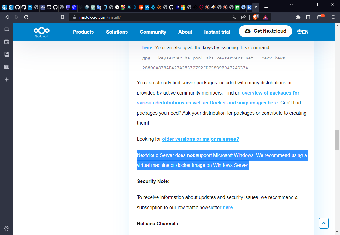

Since Nextcloud Server does not support Microsoft Windows, you are on your own.
