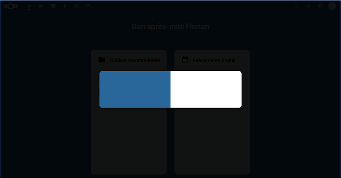

Since I upgraded my Nextcloud server to the latest version (32.0.1), I’ve been getting a sort of pop-up (or banner) appearing at the top of the webpage that blocks access to the interface. I can’t interact properly with the page while it’s displayed.
Has anyone else experienced this issue?
Do you know how I can identify where it comes from or how to remove it?
Thanks in advance for your help!

Does it works if you disable the firstrunwizard app?
Thanks a lot for your help! Disabling the firstrunwizard app did the trick. I hadn’t thought of that at all :grinning_face_with_smiling_eyes:
Really appreciate you taking the time to share the solution!
# sudo -u www-data php occ app:disable firstrunwizard
firstrunwizard 5.0.0-dev.0 disabled
