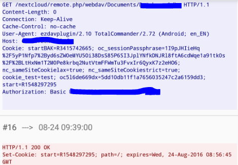

I did some traces on my Android phone. I have seen only one difference. From apps that aren’t working, there are no cookie in the request :
The cookie is set in this first request
When it is working there is a cookie.
Total commander is working because it does a first request without a cookie where he gets a 503 error and the cookie. It then does a new request with the cookie and all is working.
