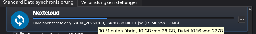

For >300 GB, I suppose it take quite some time. But do you see a reasonable data transfer?
No, and that is my main issue.
The client shows that it is downloading files, making no or almost no progress. It should be uploading files, and make reasonable progress. I can understand that maybe, when just started, the client wants to check for changes on the server before uploading local changes. But that shouldn’t take very long, and I know that there are no changes on the server. I waited for multiple hours, but noticed no real change.
I understand that uploading >300GB of data can take time, maybe even several days, even with good quality network connections (I have ~30Gbps upload, the server itself is a lot faster). That is not the issue. But now, I see no progress at all.

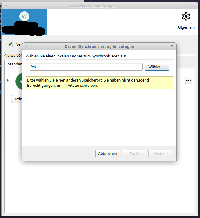

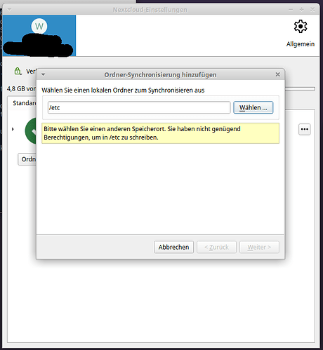

I really wonder how you made it possible to sync /etc-Folder with NC-Client on Linux. The Users have no write permission in /etc. The client (Nextcloud-4.0.6-x86_64.AppImage) does not accept for that reason /etc as folder for a sync.
So did you changed Owner of /etc or do you run Appimage as sudo?
Both is not recommended.

It’s good that you’ve clarified that now. Since /etc is a system folder that exists on every Linux system, your previous information was unclear.

Yes, definitely too slow and not normal, I would say. And yes, when I hear all this, it sounds like a problem with the client or synchronization mechanism. Unfortunately, I don’t know enough about the technical details. Maybe someone else has an idea..
Also, I can’t really try to replicate it, at the same scale. However, I did upload a smaller folder containing 2,278 files and didn’t experience any of the issues you describe. The performance isn’t great, but it’s also not as bad as yours, and the UI stayed responsive at all times.
