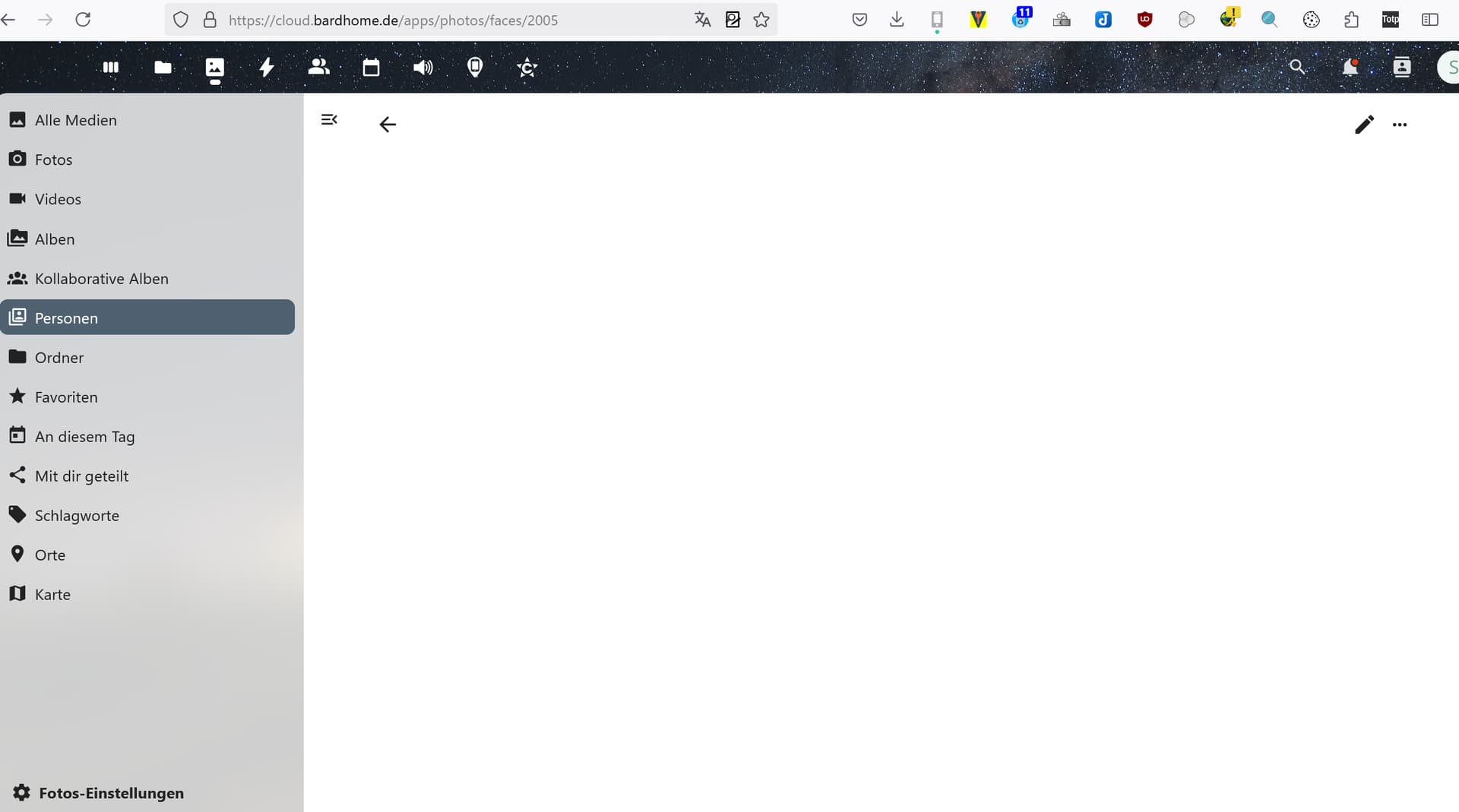

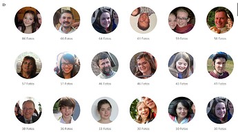

The photos app shows the overview for faces, so this here:
apps/photos/faces/2005

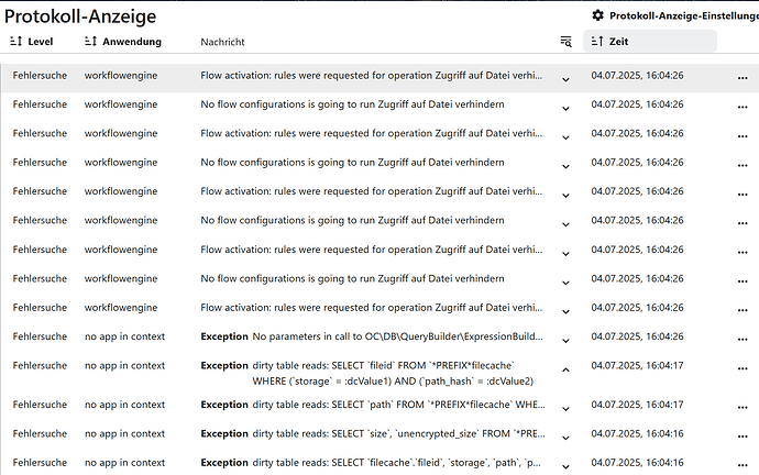

But when I click on a single photo, there is this “clock” rotating and shortly I can see some blank boxes, but then no picture is shown. Restarted the server already. No errors thrown otherwise in the protocol.

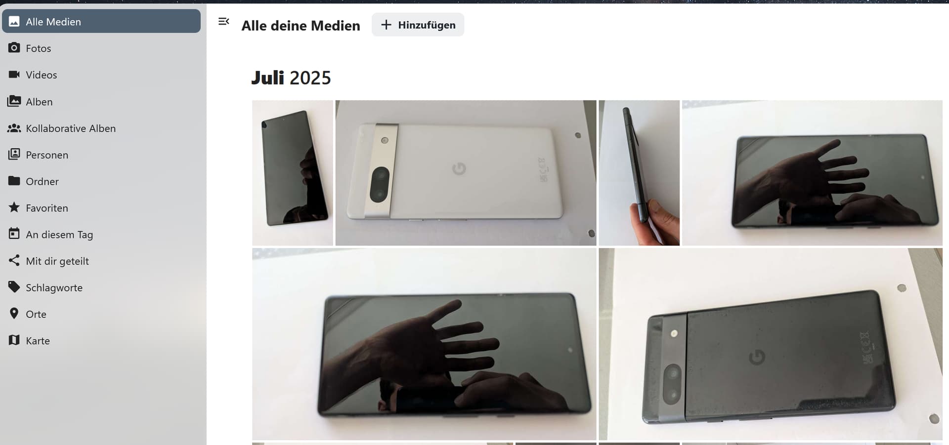

  • permissions seem alright (in filesystem everything www-data), in container also accesible. The photos app itself seems ok, meaning that I can access photos via “all your media”

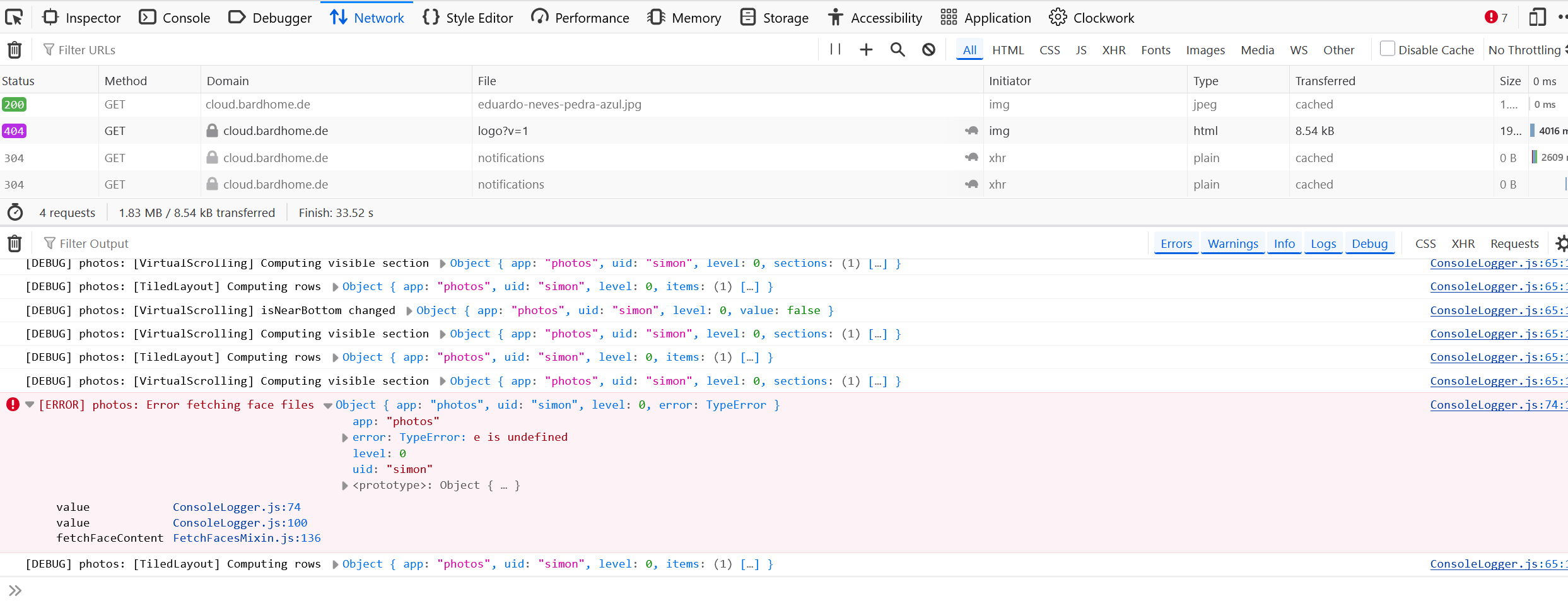

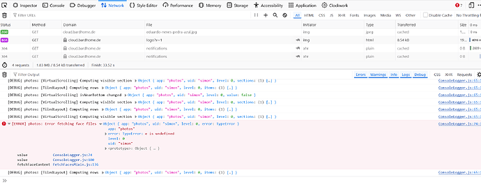

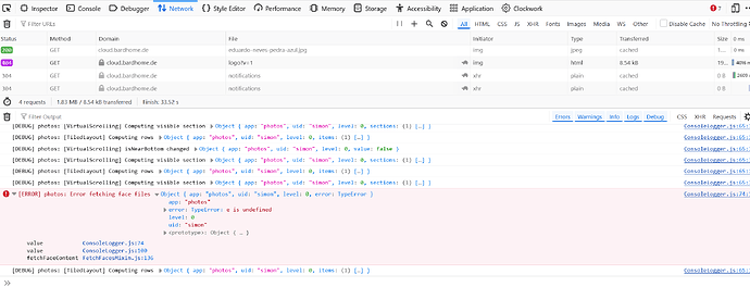

The browser seems to have some errors, yes. Sorry I have no clue what they mean and how to fix:
After having similar issues with photos, I would recommend to have a look to the database. Especially in my case the original preview files in appdata_xxxx/preview got lost, but the database entries pointing to them in table oc_filecache remained and were not affected by rescanning files.
I had to delete the database entries by using
delete from oc_filecache where path like ‘appdata_%/preview%’;
(this will delete all references to any preview files, so please be cautious!)
Then the instance recreated all the preview files either by preview generator or while accessing them online.
