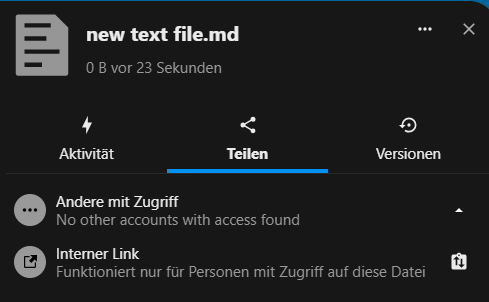

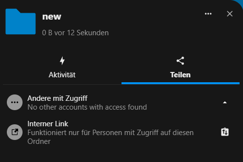

But if I try to create a new share - either for internal users or sharing by link - I can not do this, as the dialog does not exist. I only can “create” an internal link …
As you can see on the screenshots there is no option to search for users or to share a link.

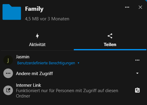

If I try to investigate or reconfigure existing shares the behavior is slightly different. First when I check the share it seems quite okay - like this:
So I see the share and i also see it is shared to internal user named “Jasmin” with user-defined permissions.

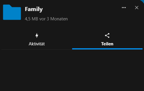

But when I click either on the three dots or on the permission entry everything goes wrong:
Unfortunately there are absolutely no errors (even no information or other entries) in nextcloud log when this happens.
And the share “Family” still works fine.

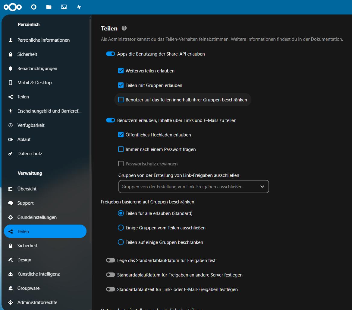

My config.php looks like this:

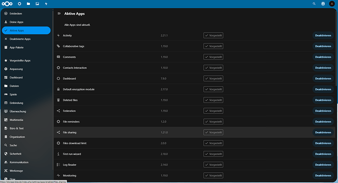

Overview of installed apps:

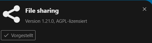

Nextcloud file_sharing app:

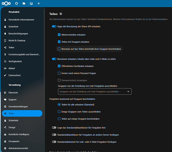

Settings for file sharing:
