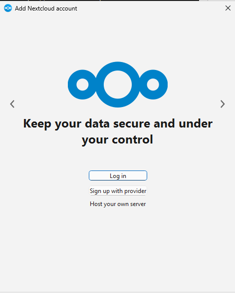

I have installed the NC client MSI on a windows 11 PC, but have not added any user accounts because I am trying to automate the adding user accounts process. Basically, if I run NC I get the Add NC account screen, which is what I want:

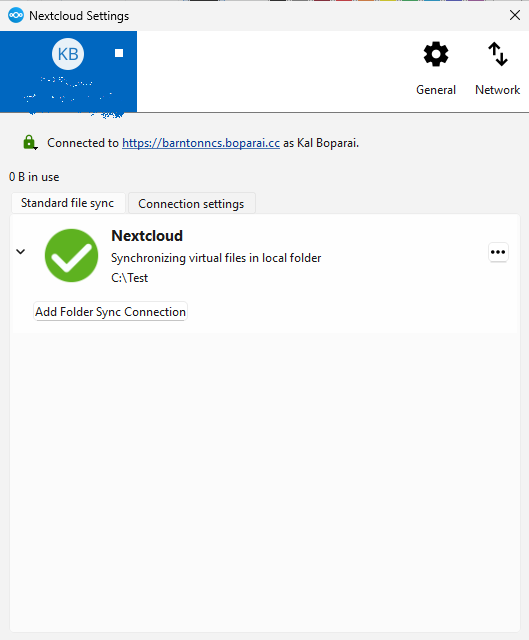

This will work by connecting to the user account on the NC server, but it does not set the default local sync folder for the NC Server to connect to:
I can create the local sync folder manually by clicking “Add Folder Sync Connection” and going through the wizard and everything works fine, however this defeated the purpose of “Mass Deployment” as you need to add the local sync folder manually and do additional steps in the wizard. I only did this command with the minimum arguments for testing just to make sure I can establish a connection between the NC windows client and NC server.

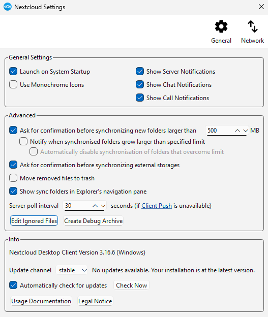

Also, if someone can tell me how to change these settings via the command-line, that would also be appriciated:
Thanks in advance for any help

Just a quick update, I got it working a little bit more, it was the security permissions set on C:\Test
So now if I use C:\Test as the local sync folder with the command:
C:\PROGRA~1\NEXTCL~1\NEXTCL~2.EXE --userid %username% --apppassword <my_generated_app_password> --localdirpath C:\Test\ --serverurl https://<my_domain.com>
Everything works as it should and the local syn folder is setup properly.
