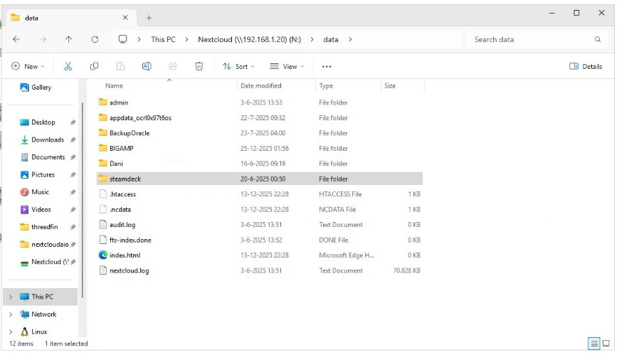

The only thing is im trying to set my datadir as a external share that runs on my truenas server.

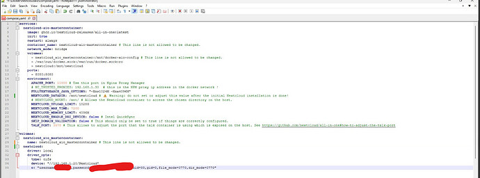

I run windows server 2025 with docker engine and docker compose. I also have WSL installed.

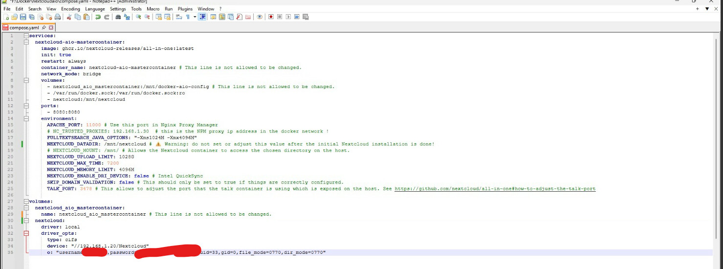

In the compose.yaml i made a new volume that links to my share(see photo).
But when i try to set that volume as my netxloud_datadir i get the error that my datadir needs to start with a “/”. But how can i do that if it needs to link to the docker volume?
My master container also links to that volume(see photo). When i enter my mastercontainer and cd to its location i can see the files.
So my question is what is the right way to set the datadir for my nextclou-aio-nextcloud container?
