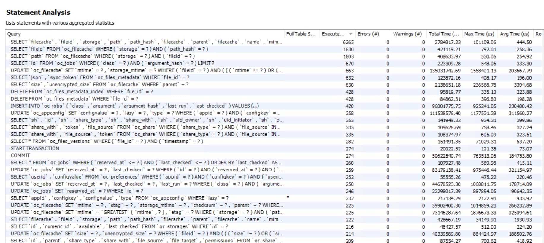

The issue you are facing:
File operations (upload, rename/move) are extremely slow. For example, MOVE commands are currently taking between 12 and 30 seconds per file.
Other info:
- mysql slow query logging at 2 seconds shows no correlated slow queries

- running non-virtualized on (basically) dedicated server with i7 CPU, 8gb ram, newer HDD
- uptime load typically around 2-3
- htop shows 2.6gb out of 8 used; low CPU (<10%) all around
