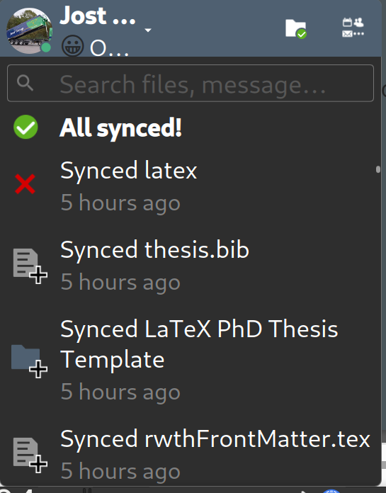

I searched the trashbins on server- and client side: no trace of my recent edited files. The client shows me this:
When I click on the files, I only get the old versions.
