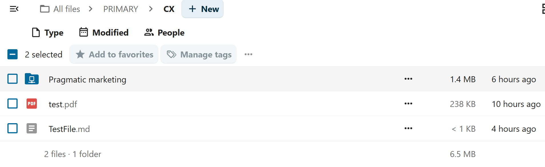

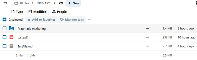

  7. Copy (don’t move) a file from primary storage to the new external storage volume - or upload from local storage. It should move to the volume with no problem.
  8. Attempt to open the file. It fails. Try to download the file. It fails.

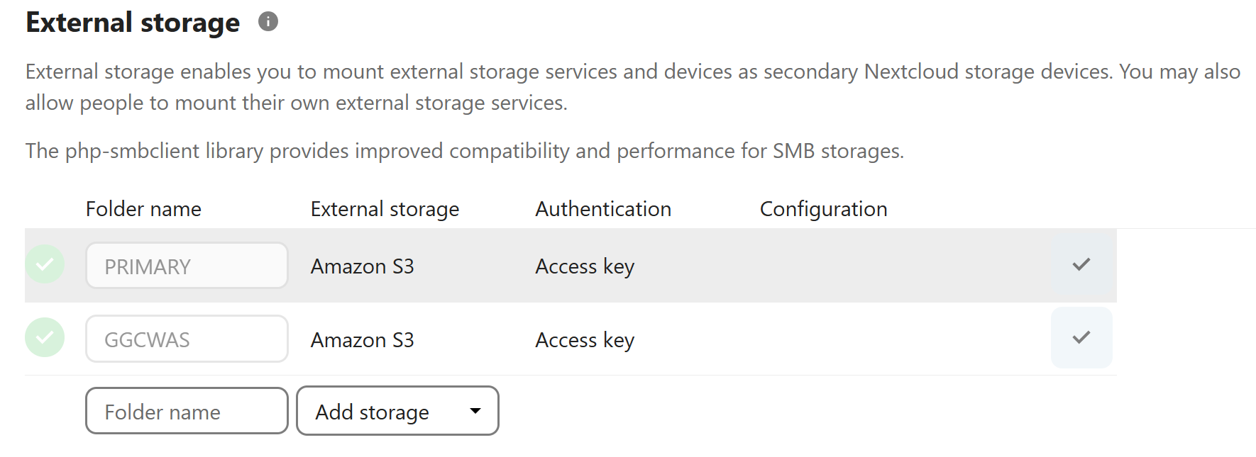

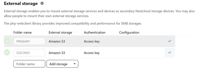

2 seemingly successfully installed s2 storage buckets.

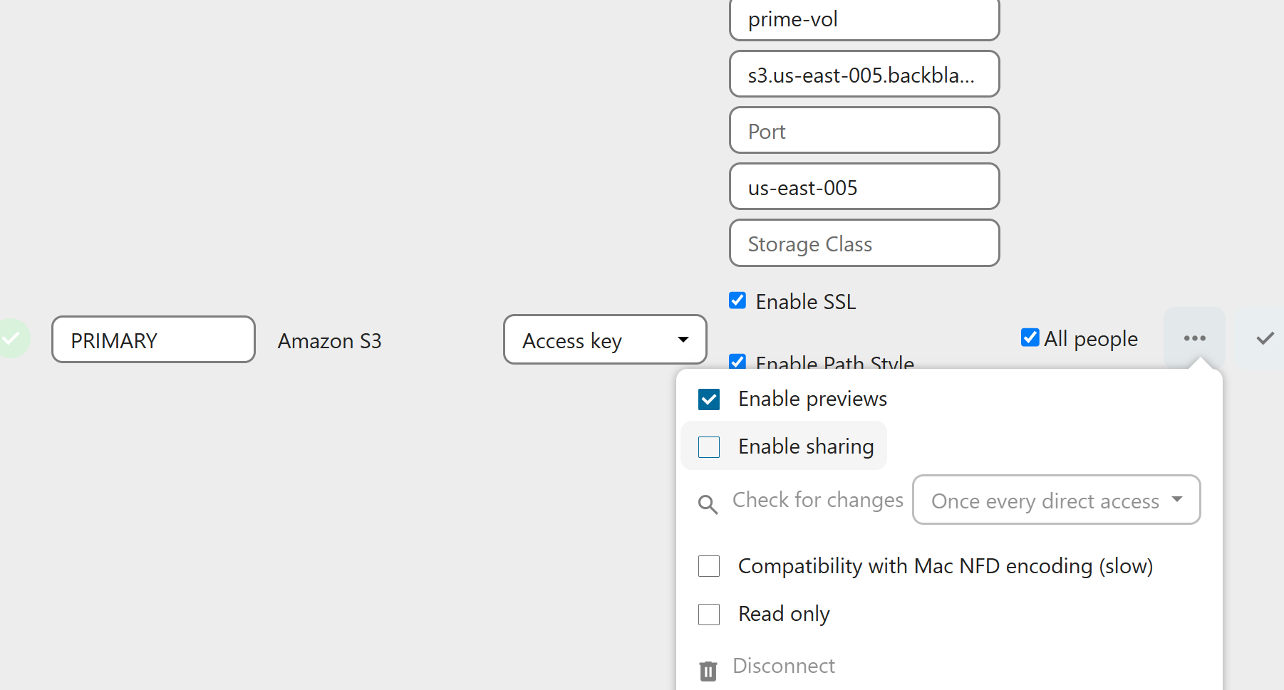

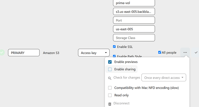

No share option visible:
This is the external storage form that is not reflecting the CLI enable_sharing command.

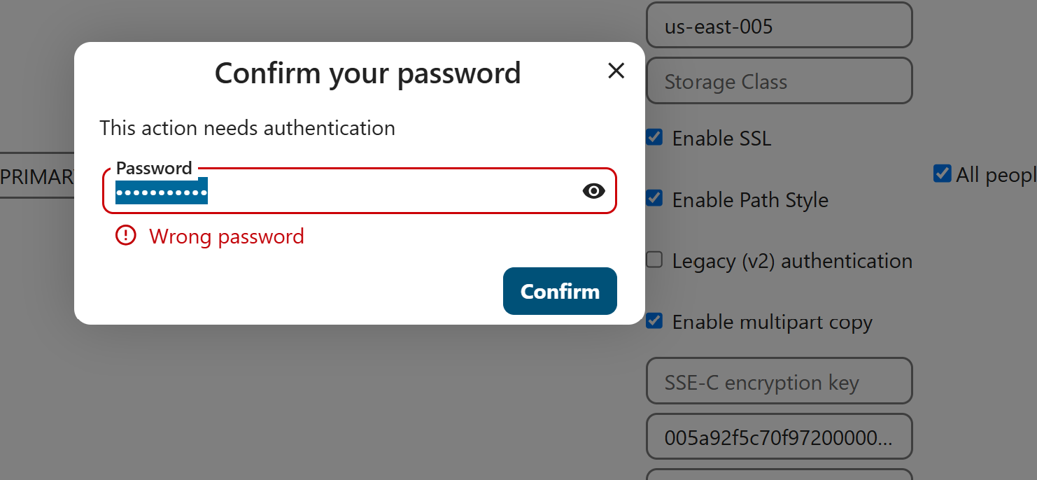

All the other fields in this form were inserted via occ CLI, not in the web UI. The webUI requests password:
…and ALWAYS fails, despite a correct password.

In administration settings, go to external storage and fill form. Don’t waste a lot of time here trying to get it right. Attempt to save your form edits. It requests password. Upon entering it errors: wrong password (bug - dead end)
What appears in your browser inspector Console and Network tabs when this occurs?
