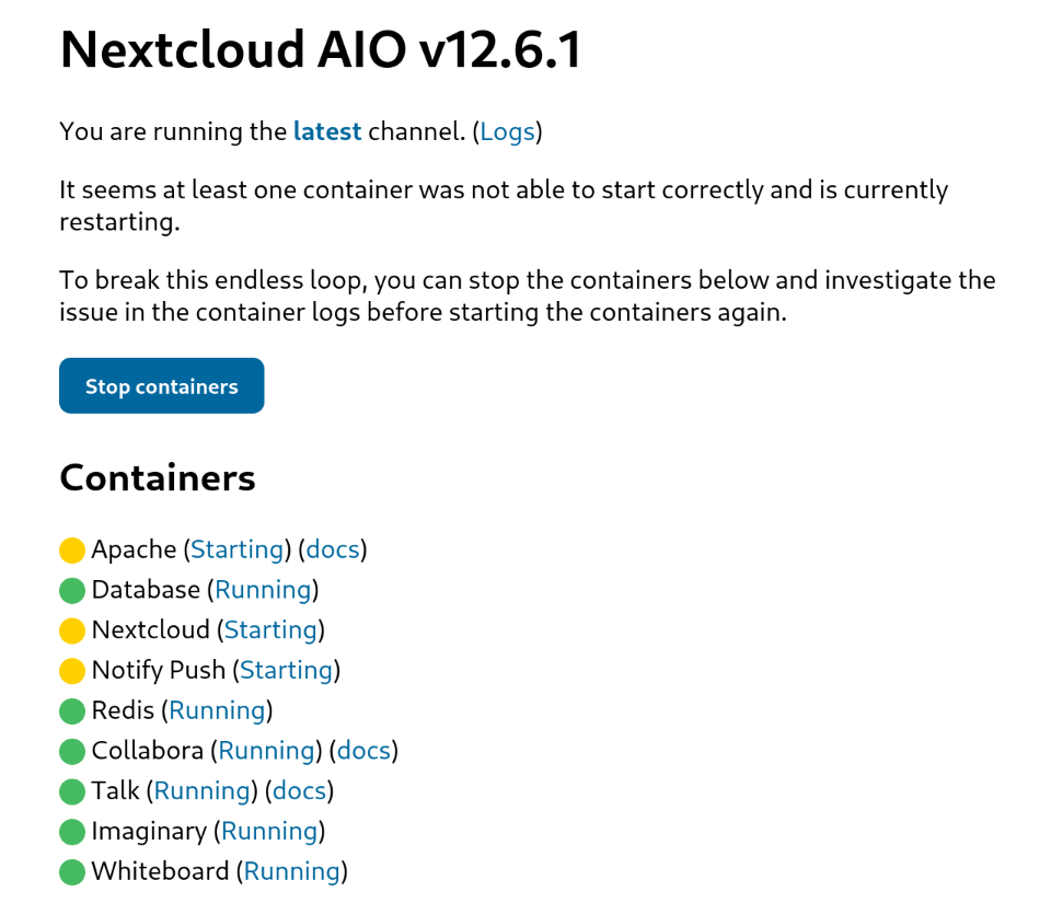

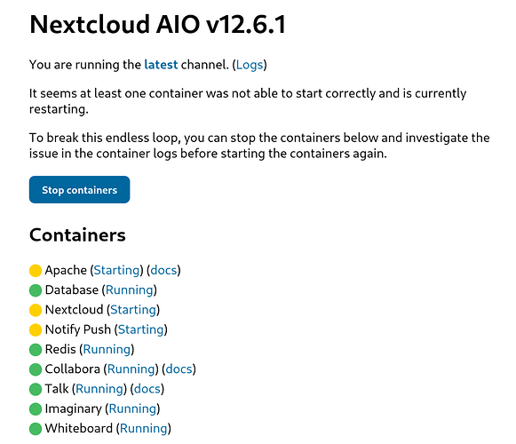

I am having problems installing Nextcloud AIO with docker rootless. Specifically, I have a problems with file permission. This is the situation of my containers:
Apache and Notify Push can’t ping Nextcloud. So I hope that when the Nextcloud work the other two will start to work as well. Yesterday the nextcloud container was not working because of this error:
