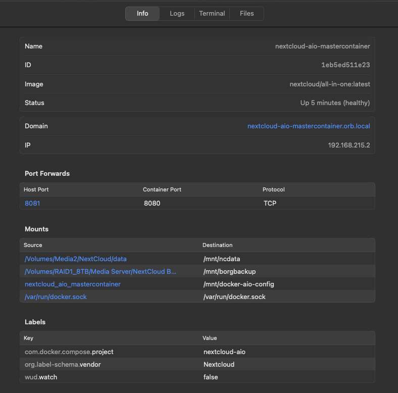

When I try to restore a local borg backup, the AIO restore process results in no folders found.
This was my attempt:
docker run \
--init \
--sig-proxy=false \
--name nextcloud-aio-mastercontainer \
--restart always \
-p 8081:8080 \
-e SKIP_DOMAIN_VALIDATION=true \
-e AIO_BACKUP_MOUNT=“/mnt/borgbackup” \
-v nextcloud_aio_mastercontainer:/mnt/docker-aio-config \
-v “/Volumes/Media2/NextCloud/data”:/mnt/ncdata \
-v “/Volumes/RAID1_8TB/Media Server/NextCloud Backup/Docker Backup”:/mnt/borgbackup \
-v /var/run/docker.sock:/var/run/docker.sock:ro \
nextcloud/all-in-one:latest-arm64

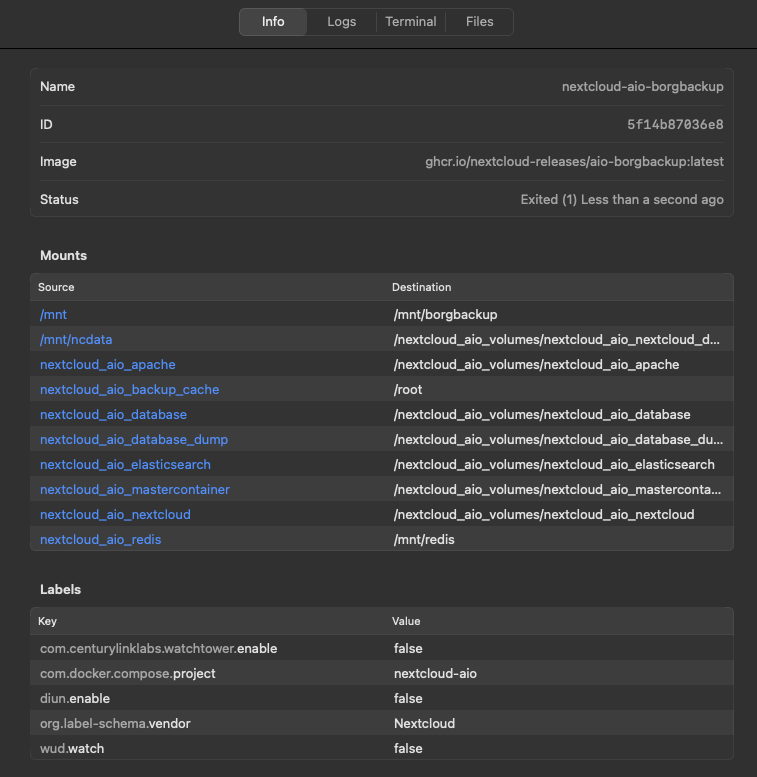

When I put in the local backup location (/mnt/borgbackup), it throws this:
2026-03-03T16:15:02.197005731Z No ‘borg’ directory in the given backup directory found!
2026-03-03T16:15:02.197020772Z Only the files/folders below have been found in the given directory.
2026-03-03T16:15:02.197098064Z .
2026-03-03T16:15:02.197102856Z ..
2026-03-03T16:15:02.197133272Z Please adjust the directory so that the borg archive is positioned in a folder named ‘borg’ inside the given directory!
  1. run the config, ive tried the above and also this one
docker run \
--init \
--sig-proxy=false \
--restart always \
-p 8081:8080 \
-e AIO_BACKUP_MOUNT="/mnt/borgbackup" \
-e NEXTCLOUD_DATADIR="/mnt/ncdata" \
-v "/Volumes/Media2/NextCloud/data":/mnt/ncdata \
-v "/Volumes/RAID1_8TB/Media Server/NextCloud Backup/Docker Backup":/mnt/borgbackup \
  1. Go to the 8081 address and log in with the code provided
  2. Paste /mnt/borgbackup into the “local backup location” and password
  3. Check the logs - fails to see any folders. If try to enter folder one up, I get this

I tried this troubleshooting step
docker exec nextcloud-aio-mastercontainer ls -la /mnt/borgbackup
total 12
drwxr-xr-x    1 root     root           128 Jan 29 05:06 .
drwxr-xr-x    1 root     root            66 Mar  3 16:13 ..
-rw-r--r--    1 root     root         10244 Mar  2 16:31 .DS_Store
drwxr-xr-x    1 root     root           512 Mar  1 17:11 borg
So, the container can see the files.. but for some reason on the AIO interface, it can’t.

Hi, can you enter /Volumes/RAID1_8TB/Media Server/NextCloud Backup/Docker Backup as backup path and check if that makes it work?
Thank you! this seems promising. I got this
`2026-03-03T17:27:17.317967856Z Passphrase supplied in BORG_PASSPHRASE, by BORG_PASSCOMMAND, or via BORG_PASSPHRASE_FD is incorrect.
2026-03-03T17:27:17.327577169Z The entered path seems to be valid but could not open the backup archive.
2026-03-03T17:27:17.327608294Z Most likely the entered password was wrong so please adjust it accordingly!
