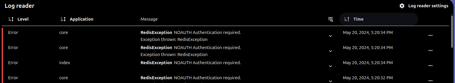

Wow I hadn’t looked at that log till now, it’s full of redis NO Auth errors.
I googled a solution and saw to do this:
So I just opened /etc/redis/redis.conf
I ran
openssl rand 60 | openssl base64 -A
to make a password
where it says requirepass I entered the pass I generated.
Then ran
redis-cli -h 127.0.0.1 -p 0 -a “$your_password”
It says connection refused.
That was what a search result said to do.
