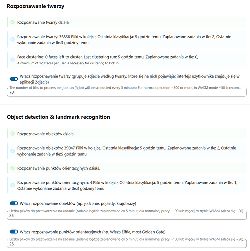

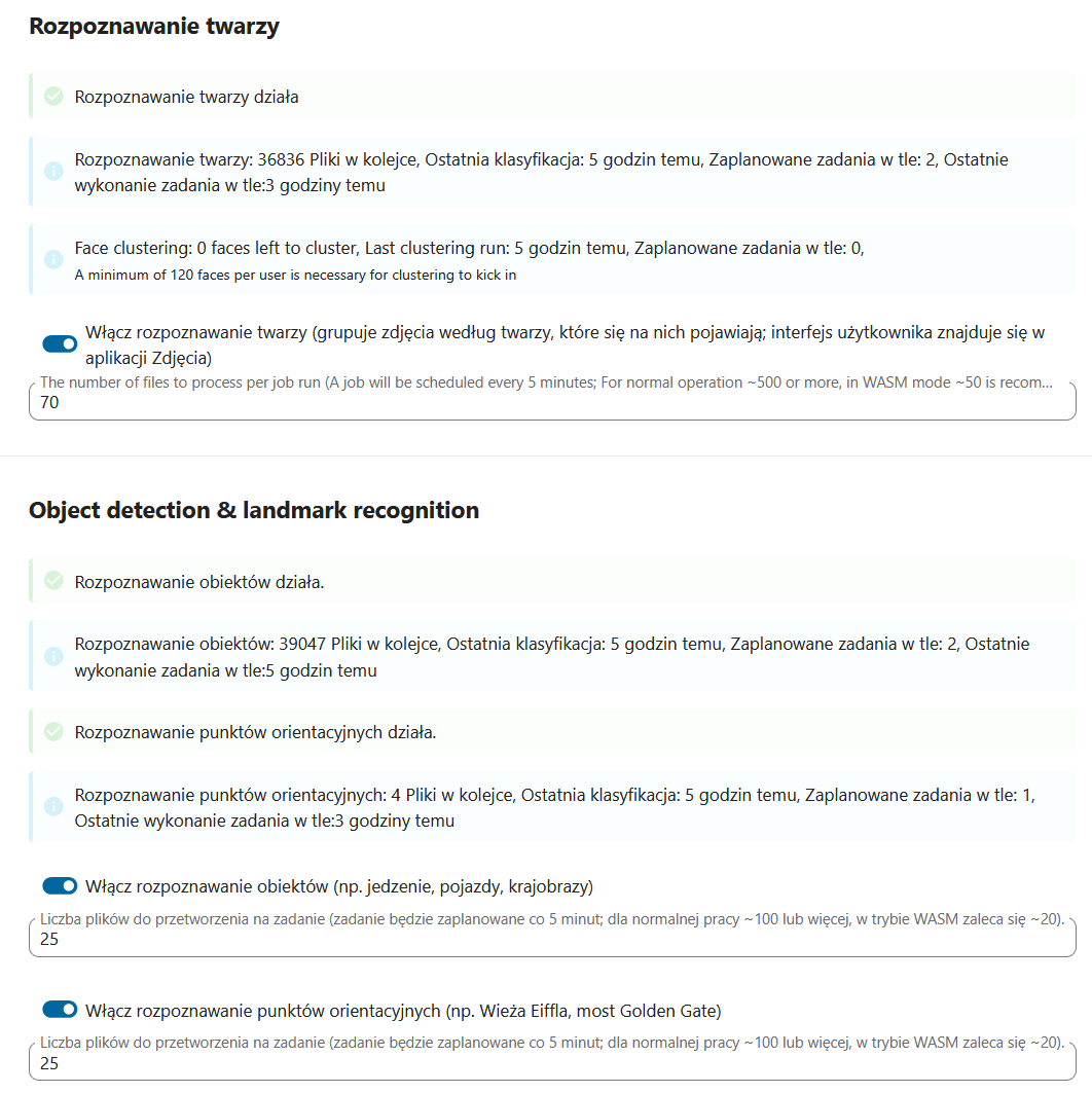

I installed Recognize, and it appears to be scanning files; however, at a certain point the process seems to stop, and I’m not sure why. Is there a way to verify what’s happening and resolve the issue?
mmh, it seems your database may have problems? “Failed to connect to database” is not a recognize issue, I think
I’ve noticed that the number of files in the queue drops every night (few thousands every night…), so it seems like the recognition process kicks in after dark. For some reason, though, it stops around 6 or 7 AM. Why is that?
Recognize adheres to the Nextcloud server’s “maintenance window” setting: Background jobs — Nextcloud latest Administration Manual latest documentation If you have this set in your config, recognize will only run during the down times of your server when no users are active.
