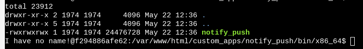

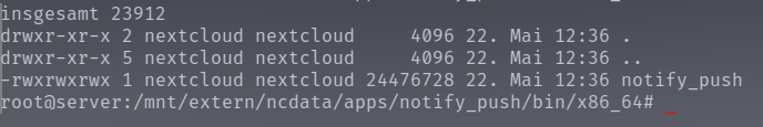

I tried installing nextcloud in docker compose with portainer based on this guide
unfortuantely I got several issues and will cluster them a bit. I did not analyse them yet but if you already know the answer :wink:
  • shown in system / docker
    • AH00558: apache2: Could not reliably determine the server's fully qualified domain name, using 172.29.0.4. Set the 'ServerName' directive globally to suppress this message → seems to be no problem
    • Notify_push got insufficient permission even the file is chmodded to 777,
    • login redirect does not work (stuck on loading) → worked after stack restart
    • Content-Security-Policy: Die Einstellungen der Seite haben das Laden einer Ressource (img-src) auf http://sub.myzone.dedyn.io/index.php/apps/calendar/public/getCalendarDotSvg/%23B8BE68.svg blockiert, da sie gegen folgende Direktive verstößt: “img-src ‘self’ data: blob: https://*.tile.openstreetmap.org” 3 NcAvatar-C7__uk4K.mjs:575:6 → somehow it was gone
    • cron container can’t access the database
    • notify push container does not know the file / folder (I guess because of the following error).
    • apps are not stored on my specified host system path
      - the nextcloud container becomes unhealthy after a short time. Doing the health check command on the server (via SSH), I see the message “Moved permanently”. running th ecurl within the container, I do not get a response (too impatient to wait more than 3 minutes for an answer). Maybe it is a coincidence, but the redis contaienr got problems befor ethis error occures (see log section please :slight_smile: ) → when restarting the container nextcloud works again
  • shown in nextcloud
    • background job not running (guess because cron error mentioned before)
      -The reverse proxy header configuration is incorrect. This is a security issue and can allow an attacker to spoof their IP address as visible to the Nextcloud → removed overwrite environment variables
      -Accessing site insecurely via HTTP. You are strongly advised to set up your server to require HTTPS instead. Without it some important web functionality like “copy to clipboard” or “service workers” will not work!
    • Some headers are not set correctly on your instance - The Strict-Transport-Security HTTP header is not set (should be at least 15552000 seconds). For enhanced security, it is recommended to enable HSTS. → in traefik I enabled the STS headers (updated the env file)
    • The database is used for transactional file locking. To enhance performance, please configure memcache, if available → did not do something knowingly
    • RedisException ->Connection refused → Could not boot notify_push: Connection refused (I guess this will also be fixed when notfiy push container is running)
    • PHP → Array to string conversion at /var/www/html/lib/private/AllConfig.php#141
I don’t know, because I assume, that this does not happen to anyone else.
Already mentioned it in errors.
 - RedisException -> Connection refused -> Could not boot notify_push: Connection refused (I guess this will also be fixed when notfiy push container is running)
 - PHP -> Array to string conversion at /var/www/html/lib/private/AllConfig.php#141

Cron Container
crond: USER cron pid 36 cmd php -f /var/www/html/cron.php
Doctrine\DBAL\Exception: Failed to connect to the database: An exception occurred in the driver: SQLSTATE[08006] [7] could not translate host name “postgres” to address: Name or service not known in /var/www/html/lib/private/DB/Connection.php:237
notify push
Failed to deploy a stack: compose up operation failed: Error response from daemon: failed to create shim task: OCI runtime create failed: runc create failed: unable to start container process: exec /var/www/html/custom_apps/notify_push/bin/x86_64/notify_push: permission denied: unknown

  • Is it a individual problem or does the cron container always need to have access to the same network as nextcloud itself?
  • Are folders and files created with wrong ownership / permissions because of portainer, or is it due to the setup? → had to adjust it for redis volume and some individual files in nextcloud folder
  • I thought the custom_apps path is automatically configured in config.php. At least I did nothave to do it on the old server. Am I wrong here?

notify push container does not know the file / folder (I guess because of the following error). But when it worked on the previous machine, the problem was insufficient permission even the file was chmodded to 777,
This is, at least in part, caused by the underlying cause of the next item.
