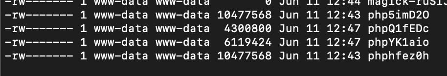

I tried uploading one folder with chrome. And then simultaneously with Firefox (via HTTP/2!) and it crashes totally!
The tmp-files stuck:
and neither in chrome nor in firefox the upload goes on…
no files are uploaded correctly. After stopping uploading in firefox, the upload in chrome goes on without any more problems…

Tried to upload a folder, a few files stuck at 10477568 Bytes:
