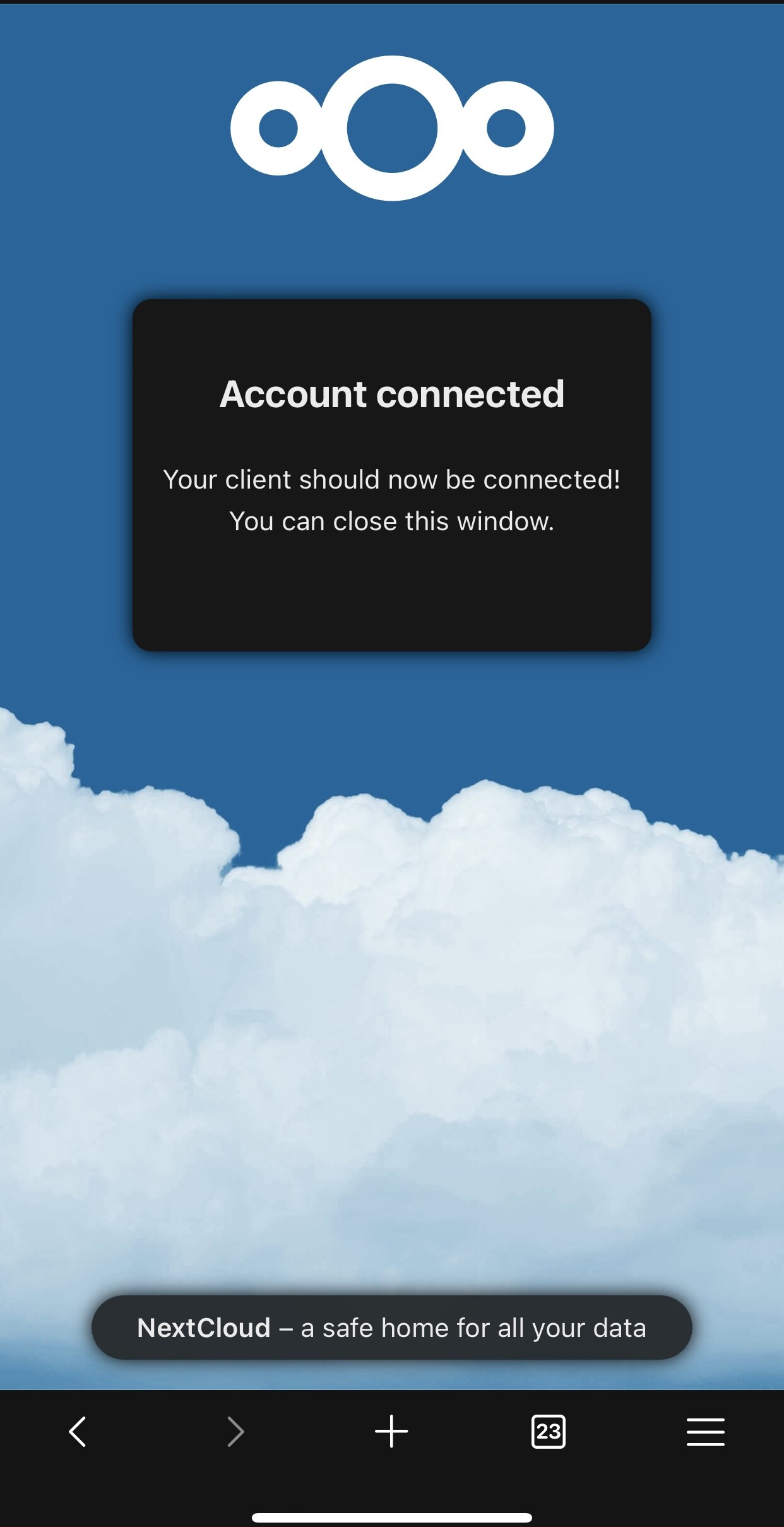

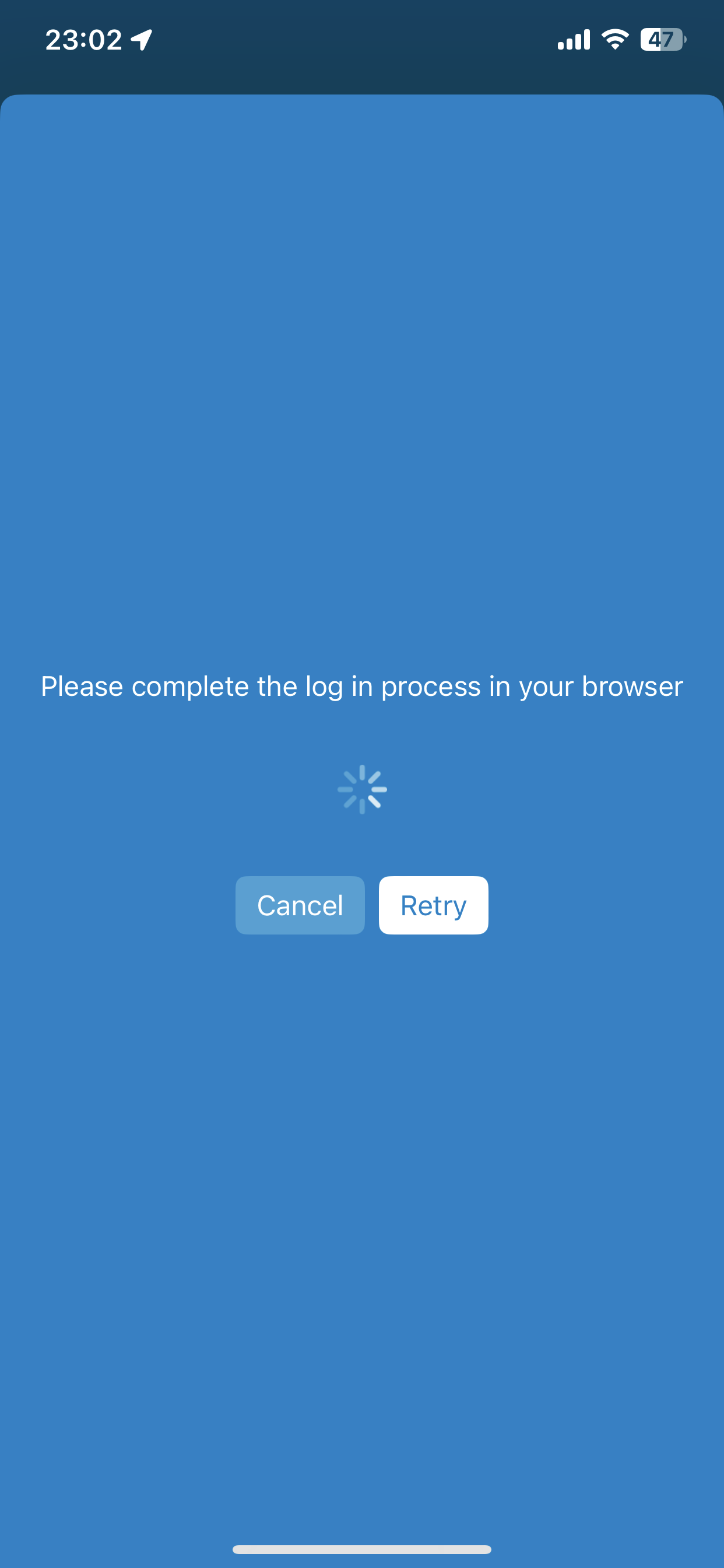

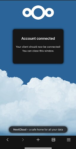

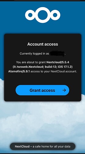

Hello. First time and freshly installed Nextcloud server (snap on ubuntu VM on ESXi) here and it is exposed to the internet. However, when I tried to log into the iPhone app, it stuck on the “please complete the log-in process in your browser” screen after successfully logging in with 2FA and granting access. Please see the screenshots for details.
What I’ve tried so far:
  1. Tried different browsers. The first thing I thought was that I needed Safari since I set Edge as default but same result.
  2. Tried different networks. I was on LTE celluar network initially and I switched to wifi for better connectivity, but no luck, either,
  3. Tried on my secondary Android phone, worked like a charm.
  4. Tried closing app and restart
Any advice or help would be greatly appreciated. Thanks.
