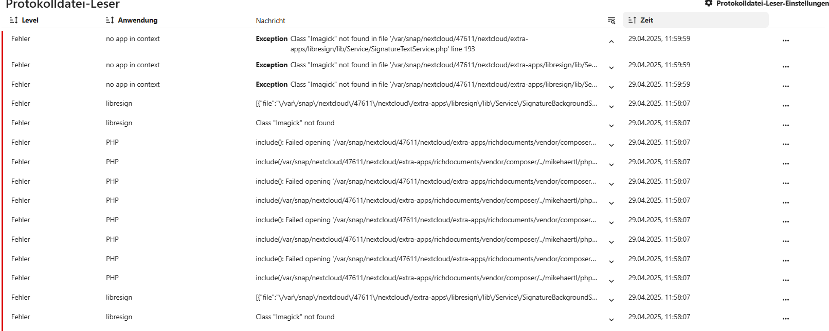

I’m having a problem with LibreSign and Nextcloud as a Snap installation.
I can send PDF documents via email, and I can open them, but when I try to sign, I always get the error message “Error creating certificate.”
What can I do to get it working?
I’m attaching a screenshot of the LibreSign settings.
I’ve already tried various certificates (OpenSSL, etc.).
I can create the signature, but when I try to sign, I get the message “internal error, please contact the administrator”

Hi, thank you very much for the video, unfortunately this does not get me anywhere.
I suspect that it is due to the Snap version of nextcloud.
The video explains that dependencies must be installed.
This happens automatically as soon as you press the button. But that’s not the case with snap
if you’re referring to binaries, then your assumption is correct, see FAQ's · nextcloud-snap/nextcloud-snap Wiki · GitHub
alternatively host libresign as a service?
