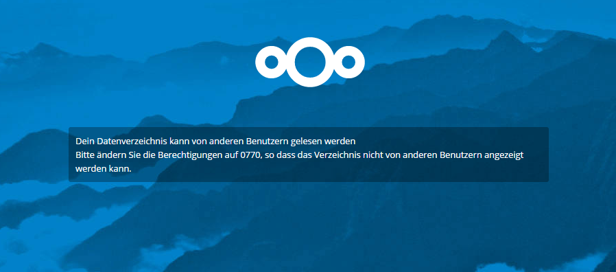

i changed the data directory of my nextcloud to an external hdd.
now iam recieving the following error:
i already changed the permissions to 0770 with the following command: sudo chmod 770 /media/nextcloud
Do i have to do anything else or why are the rights not correct set?
