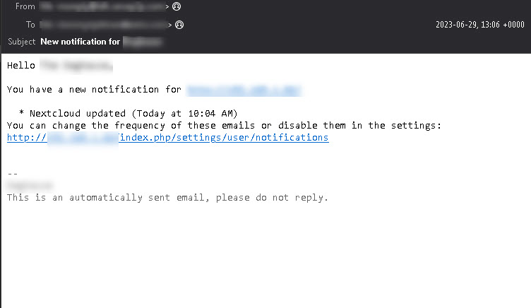

These emails looks like this for me:
When I installed NC this spring, I was on … prob v26.0.0 or 26.0.1. I’m on 27.1.1 now and I have experienced probably about 10 updates in between there. None of the updates were initiated by me. No button press, no approval, no clicking on any ā€œcheck for updatesā€, nothing. I got NC desktop client too, it updates automatically as well, although there I get asked if I want to perform the update or not.
