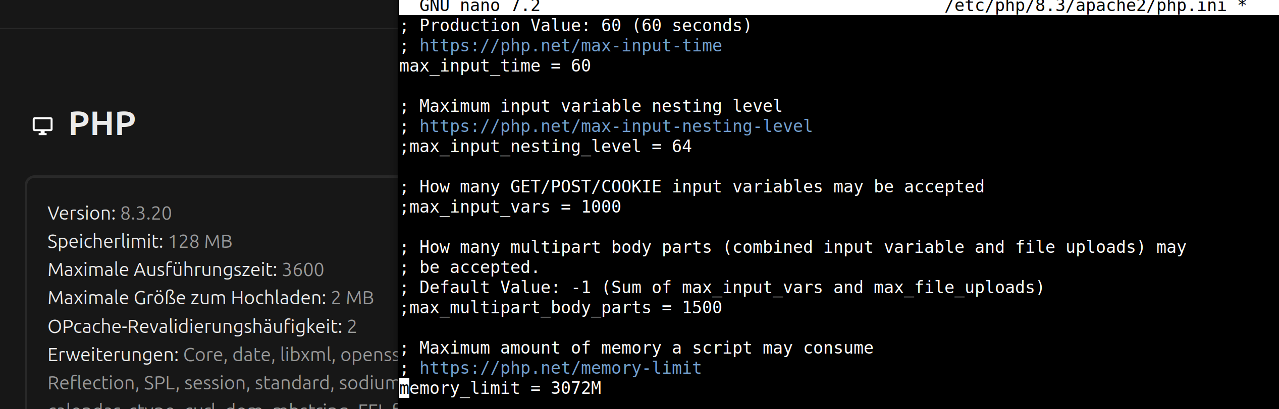

Strange problem: The Apache2 php.ini stopped affecting the Nextcloud:
The .ini has a memory limit of 3GB but the Nextcloud client states 128MB and the updater also always fails (which seems to be caused by the memory limit). Nextcloud also complains about opcache although it is configured the right way in the .ini and worked before.
The Raspberry Pi did install PHP 8.4 automatically but I changed it back to 8.3 and Apache2 is only configured for 8.3

I’m not very firm in this whole thing. Where/how do I put this test file? Apache runs under /etc/apache2/
I did reboot the whole system and I am using FPM
Edit: put the file under /var/www/html/test.php and tried http://pi-cloud.local/test.php but it says File not found.
Edit 2: php --ini returns Loaded Configuration File: /etc/php/8.3/cli/php.ini but this doesn’t seem to affect Apache2 either
Edit 3: solved it: I had changed the directory in 000-default so I had to change it back to html. The test.php returned /etc/php/8.3/fpm/php.ini which I changed and now it’s working after restarting php-fpm. Thank you very much!
