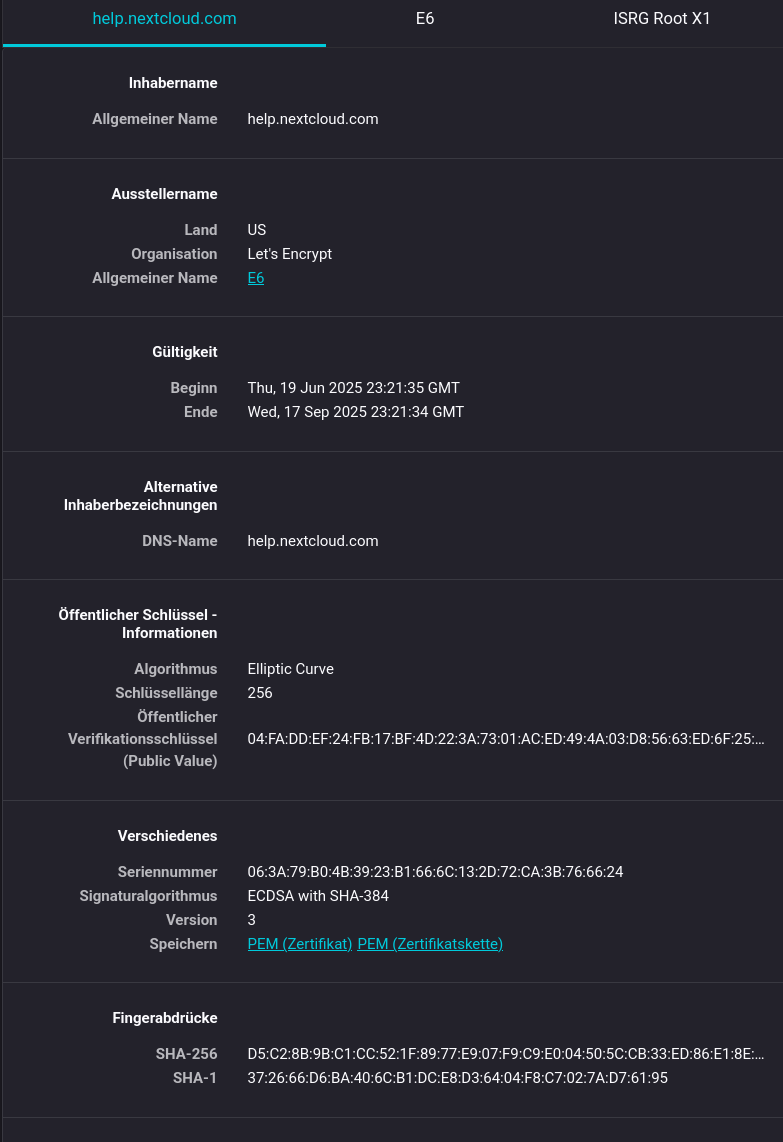

I’ve never tested this myself, but I’d say the certificate fingerprint refers to the fingerprint of the SSL certificate used by your Nextcloud server. You can get it from the command line with:
openssl x509 -in /path/to/cert.pem -noout -fingerprint -sha256
Alternatively, you can find it in your browser. For example, in Firefox:
Click the lock icon in the address bar → More Information → Show Certificate.
Here’s an example from this website (the fingerprint is shown at the very bottom of the screenshot):
I think it has nothing to do with the web ssl certificate.
I think its about the cert fingerprint of the app.
