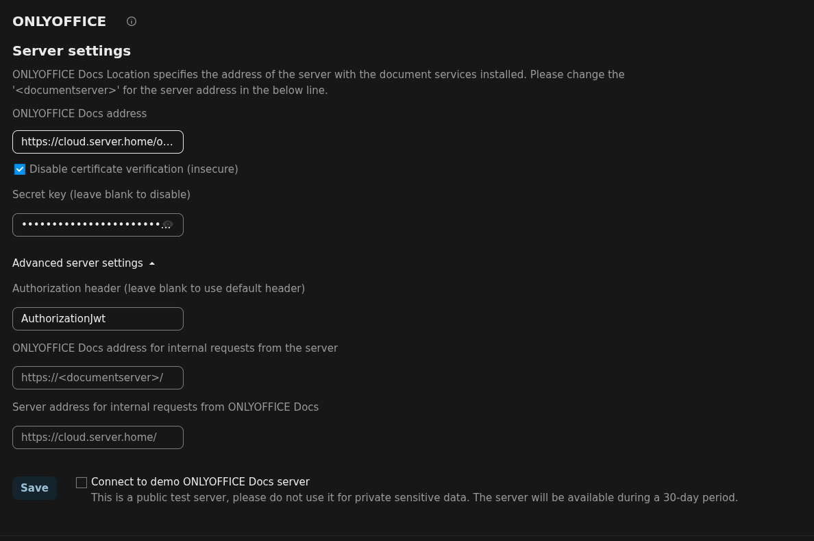

OnlyOffice server settings looks like this:
As you can see I have my custom domain cloud.server.home for my Nextcloud on my LAN network. I use Nginx Proxy Manager as reverse proxy which handles my SSL cert.

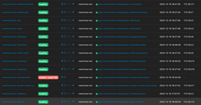

In Portainer it looks like this:
As you can see Nextcloud uses its own network 172.19.0.X and my network for other containers is 172.20.1.X so I added these ENVs into master container:

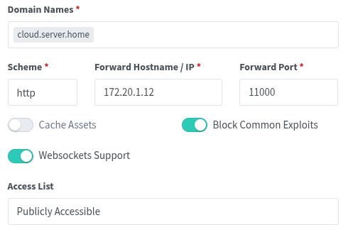

So my Apache container is visible in my home_v4 network (172.20.1.X), then I could set Nginx Proxy Manager like this:
So when I go to cloud.server.home I can access Nextcloud AIO instance and it works, just OnlyOffice doesnt work.

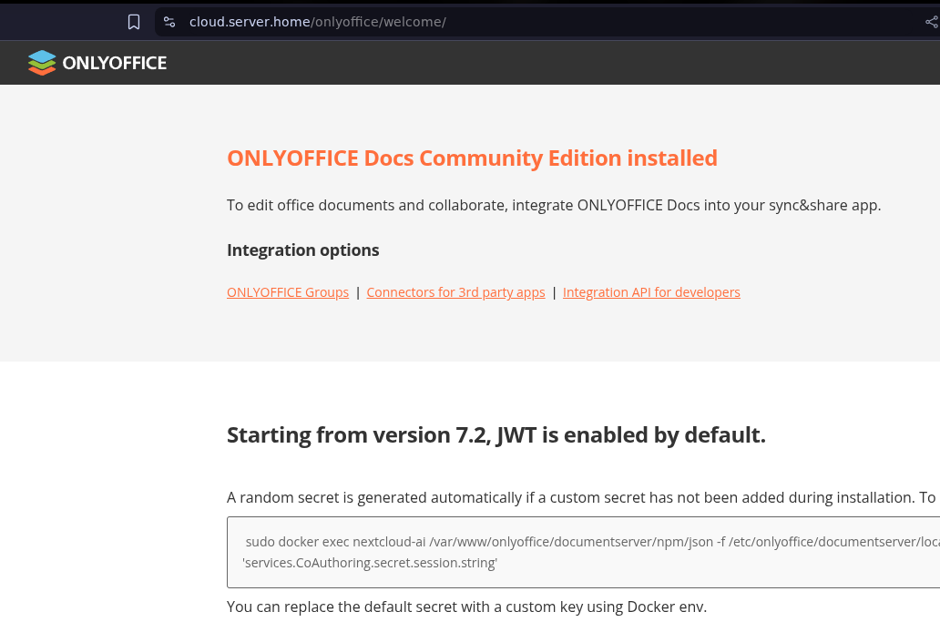

When I visit https://cloud.server.home/onlyoffice/ I get welcome page:
but when I go to https://cloud.server.home/onlyoffice/example/ or https://cloud.server.home/onlyoffice/admin/ I get 502 Bad Gateway:

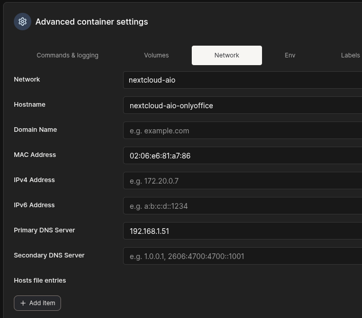

for my LAN DNS I use PiHole:
I even set it as primary DNS server for only office container:
