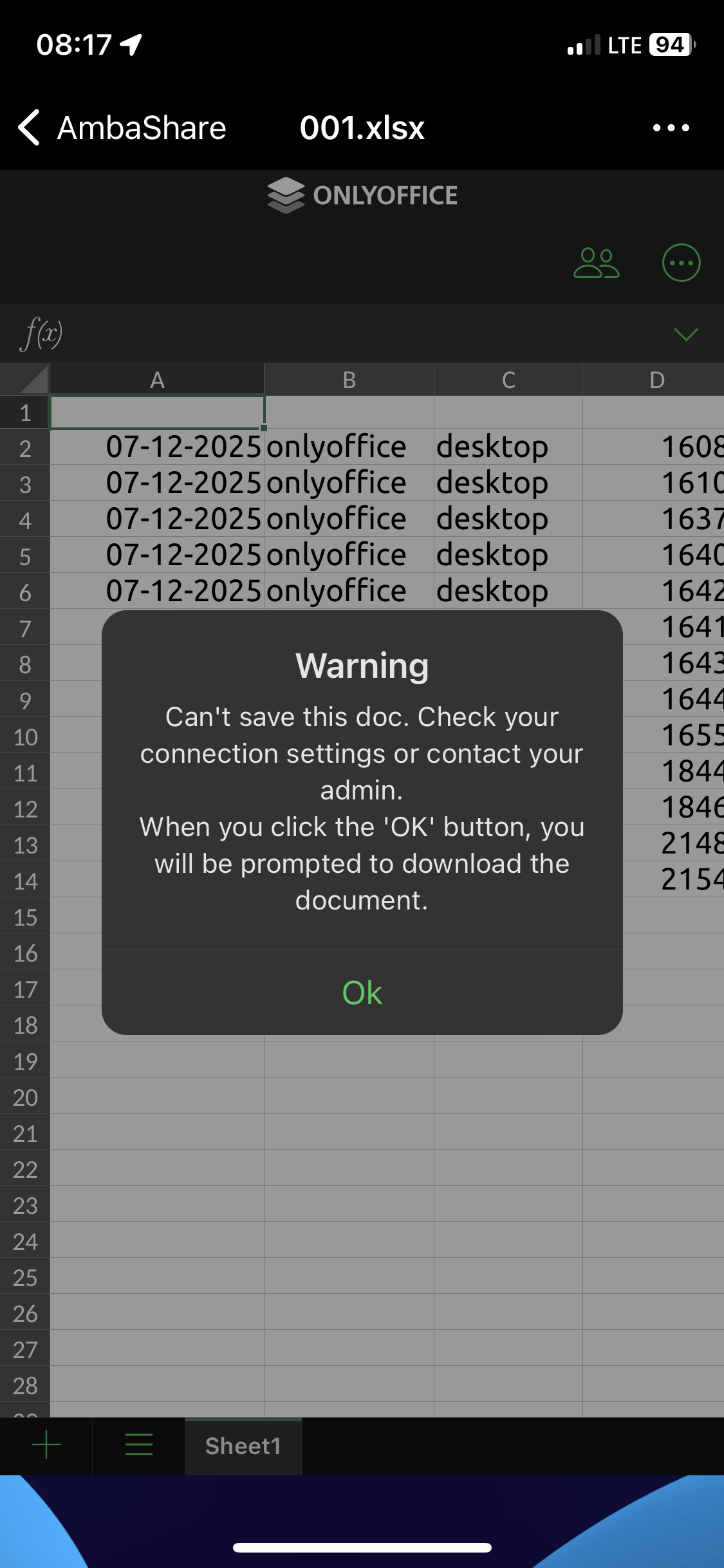

I am getting the following error every 24 hrs
my onyoffice server gets disconnected every 24 hrs
i have to open onlyoffice settings in nextcloud and haave to save server settings in order to make it work
Please somebody guide
thanks

Onlyoffice keeps disconnecting and also gives error
