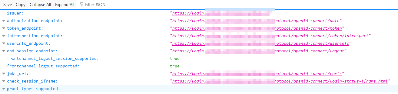

I have set the discovery endpoint to: https://authentik.mydomain.de/application/o/nextcloud/.well-known/openid-configuration
I have a valid certificate, can call the url in browser and from the nextcloud instance with curl without errors (see below).

Please review your discovery document
the endpoints are defined there it is crucial you have right URLs there with the right https:// scheme
is only required if both system run on the same host… from your post it doesn’t look like this is the case…
I am not sure what is referenced by “discovery document.” Do you mean the setup itself? The URL is set to HTTPS; I did check that. :zany_face:
Why do you think so? I run this on (virtually) separated hosts. But it just does not work without the setting. So it is needed in my setup… To me, “remote” sounds like being called via TCP or another external service.

my bad. I think jtr points to the right code - local refers not only to the same server but to all local ip subnets. and yes both ports seem to be affected :80 and :443 so there is no difference which of them is used. but I still see no reason why :80 is used if you define https: and discovery endpoint lists valid https:// URLs.
the contents of the JSON document shipped by authentik IdP on discovery endpoint - it describes the OpenID system and where to find different functionalities like authorization, UserInfo endpoints etc
this is expected as you seem to have hppt->https redirect in place. but definitely good you double check.
