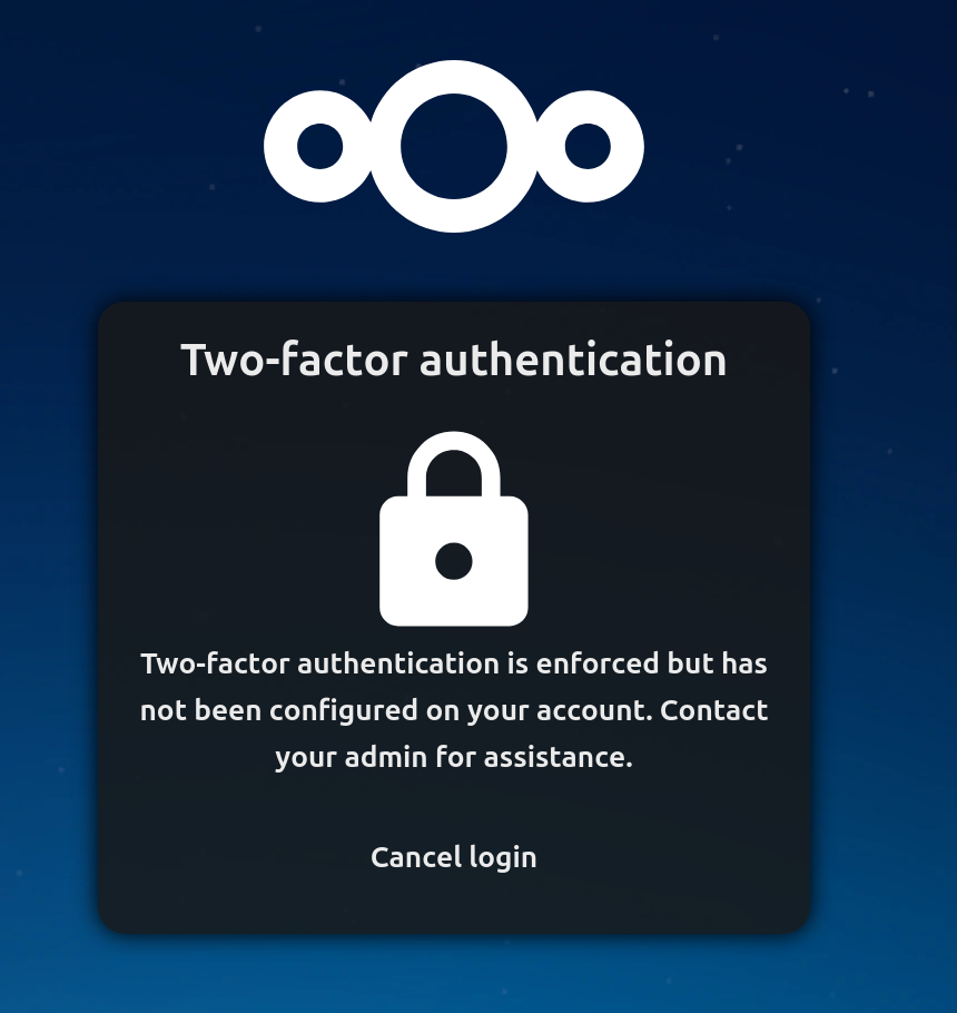

I’m running NextCloud on TrueNAS Scale as an app. When I tried to set up OAuth2, I checked to enable it for all users and my login session was interupted prior to completing the setup.
When I returned to the GUI and attempt to log in, I get this lockout message:
I read a couple similar posts involving using these commands, and see, generally. Running these commands in the shell did not solve my problem, and the shell claimed that 2FA was disabled for user admin. This prior post is more about helping a user who lost their OAuth app access get back into their account, but does not help when you lock yourself out prior to completing the OAuth configuration.

How do I unlock my admin account if I enabled but did not configure OAuth2.

Hey. I solved this problem with a slightly different shell command: ./occ twofactorauth:enforce --off
# ./occ twofactorauth:enforce --off
Two-factor authentication is not enforced
Once the shell returns this message that it is not enforced, you will be able to log in without the lockout message.
