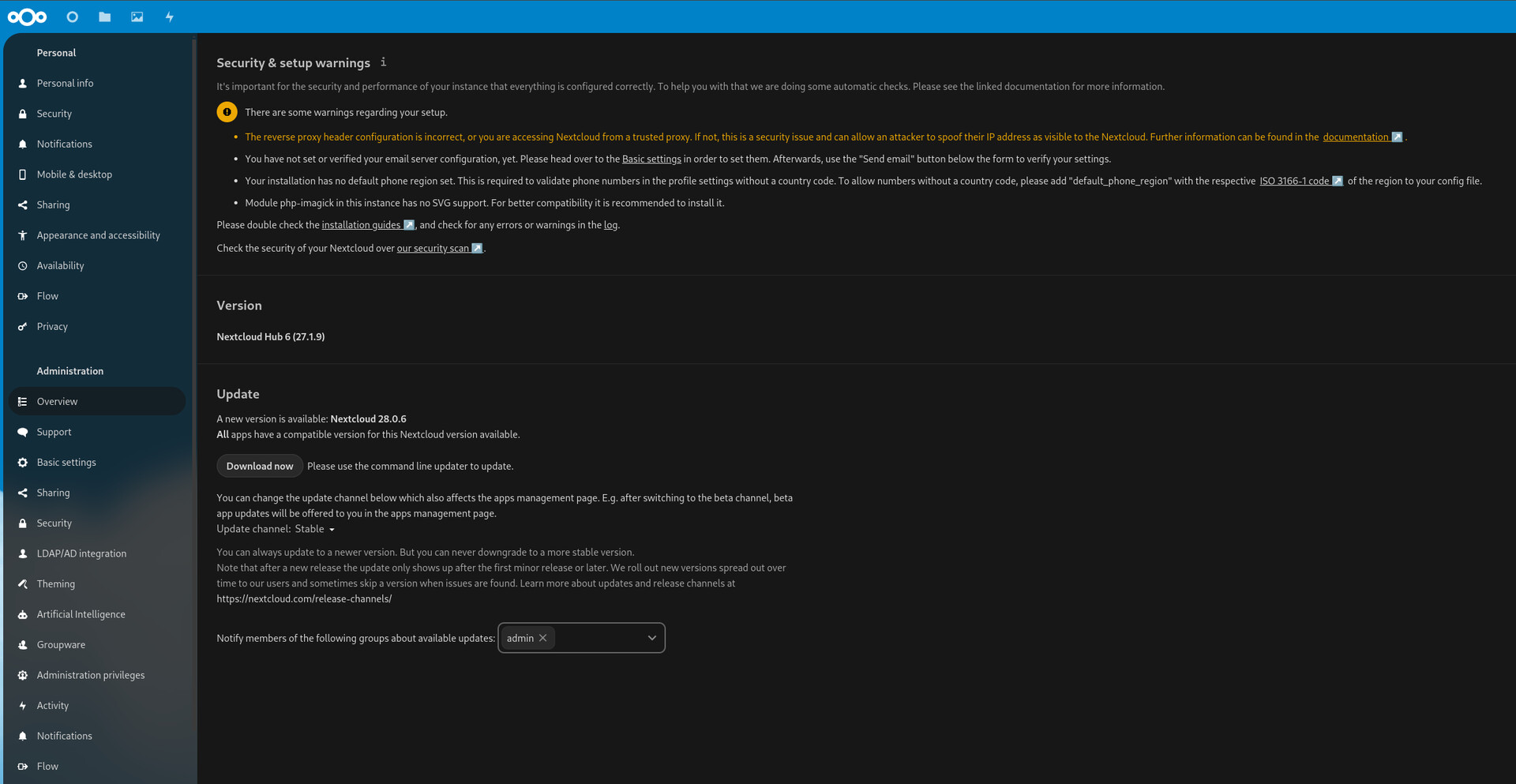

This time with the upgrade from 27.1.7 to 27.1.9 I have something fun, the notification that an upgrade is available is up and never seen before
With the same code
direct install to 27.1.9
this is fun because we use the code to do not check upgrade and do not use the webinstaller
So this are the option we use
'updatechecker' => false,
I am a bit out of clues so if you have an idea: docker.io/library/nextcloud:27.1.9-fpm-alpine
