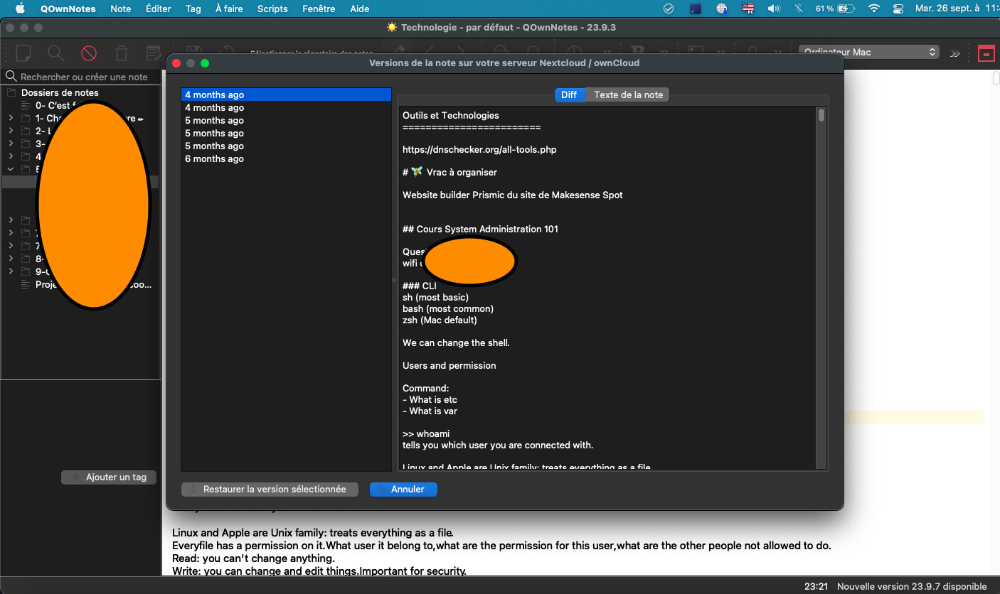

I have more information to share about the issue now.
I just retrieved an older version from 4 months ago of my lost note that got blank in Nextcloud, but it’s definitely not the last version I worked on before I lost it.
When I open Qownnotes on my Desktop, and I click on version history, first it tells me that it is downloading the history from the nextcloud server (in the footer of the Qownnotes screen), then it shows some versions older than 4 months ago (see screen shot below).
So I guess some versions might be available somewhere on my nextcloud server. But when I go on the online nextcloud platform of my server host (zaclys), I see no version history in the details of the note except for the current 0Kb version.
However when I click on Activity, I see 2 older versions, including one from 3 months ago (see screen shot)!
That doesn’t match the history versions I see on Qownnotes, which are from 4 months ago… And when I click on the 3 months old one on nextcloud online platform, it opens the blank current version. I am not sure if that would be an issue on the nextcloud side, the zaclys server side or the Qownnotes side…
